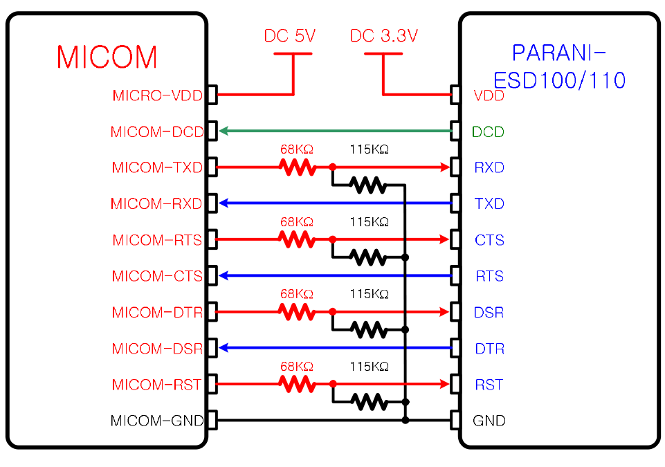

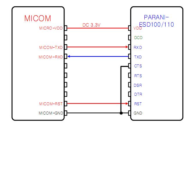

So what i understand is that the following connections are to be made
tx of uC goes to rx of bt through a 68kiloohm resistor and the other end to ground a 115kohm resistor.
rxx of uC to tx of BT
gnd to gnd and cts of bt
3.3 v power supply to vdd
some port bit to rst through same resistor pattern
cld u pls confirm if the connection is right
cld u also pls give more info abt pairing,the code and how to do it?

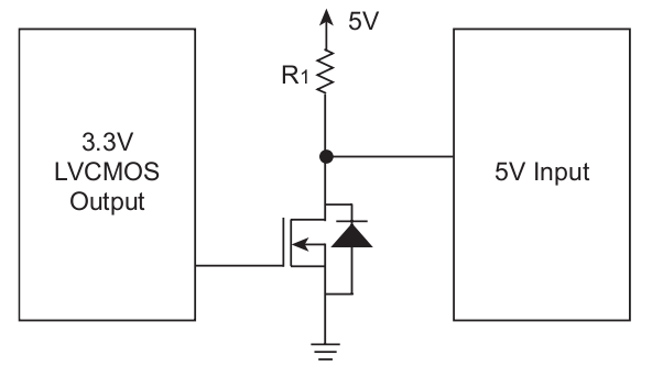

tx to rx, rx to tx .. only you need to do level shifting if your uC is operating at 5V as esd is 3V device.
you can do a level shifting different ways but you have example in the datasheet but I had problems with it as my uC did not want to recoghise 3V3 signal as 1 so I added some mosfet driver (attached)

I have attached the connection which I should be making as I am not using any hardware flow control.
There will a slight change in this diagram to account for the 5v to 3.3v and 3.3 to 5 v conversion as my uC is pic18f
the connection is ok but you need to account for the 3v / 5v difference ..
check out the https://www.electro-tech-online.com/custompdfs/2009/04/3_3vto5vAnalogTipsnTricksBrchr.pdf for examples
