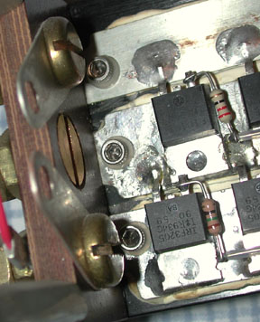

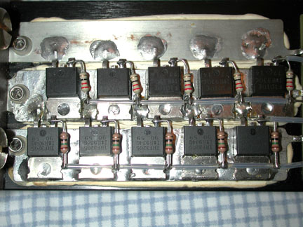

I used 0.025 copper sheet, soldered the mosfets to it, and an electrically insulating, hard-setting, heatsink material (Loctite 383). The 10 mosfets are half-H configuration with a dedicated driver on the logic board. Peak power is around 200 A (no way to measure) at 12 V. It powers a 6V Ford long-shaft starter motor running at 12V.
John

Btw, I like how you did your mosfets on the metal strips. Is their a heatsink on the back side of those with insulating thermal stuff behind them?
Yes. The whole thing is mounted to a heatsink, which is the black object behind them. John
