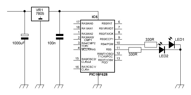

I setup one of my breadboards with a LED, 7805, and a 16F628a. I wrote a quick blinking program(random patterns) and programmed the pic. Verified the code then installed the pic on the board. When I apply current(12v-->7805) the led starts to run its pattern but with a very slow rate and the pic becomes boiling hot. What could be causing this?
Schematic:

What's the value or R?
The LED is connected backwards so it won't light.
There should be a 100nF capacitor across the supply pins of the IC.
R1 is 100k, only one I have at my desk tonight. The schematic is a little off, I just did it to show what I have done. The led lights okay(a little dim due to the 100k though).
hi gator,
The LED is drawn the wrong way around, this will not cause the over heating.
Measure the +5V on the PIC.
Also whats the rest of the circuit.?
I wasn't paying attention when placing the led on the schematic. It even does it when I just apply the current to the pic with nothing hooked to the pins.
And my multimeter is fried!(some user had it on the wrong setting when testing some high voltage...) :) My new one is in the air from Hong Kong. Could the 7805 be faulty and over powering it? Would that throw the timing off too?
100k is much to large for an LED, I'm surprised you can see it.
It could be the LM7805 but you won't know until you measure the output voltage. If the 0V pin on the LM7805 isn't connected then the output voltage might be much higher than 5V (possibly 10V) which could damage the PIC.
You also have the absolutely essential capacitors missing around the 7805 - so you've no idea what voltage might be coming out of it, or how big the oscillations from it are.
But even more likely is that you've connected the PIC the wrong way round, when they get absolutely red hot - I've got one with my fingerprint burnt in the top! :D.

I've done this test before without caps and it worked okay. I know its not right though.
I replaced the 7805 with another one and the overheating stopped but the pic didn't do anything this time(led isn't lighting up).
Did you measure regs output voltage before plugin?
Did you connect regs +5V terminal to the 14th pin?
Did you connect GND terminal to the 5th pin?
Did you check whether your LEDs working good?
Did you change your resistors?
Did you program the PIC?
Perhaps the PIC is fried?
Anyway, the other LM7805 was clearly not working I recommend you chop all the leads off and throw it away so you can never use it again.
