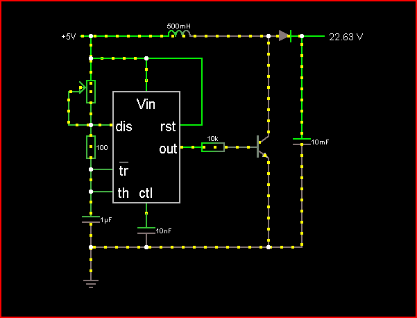

I have got a small problem. I have a basic buck boost circuit shown below:
capture-png.50871
It produces between 50-100v open load (the simulation is wrong)
Here are my values
Input Voltage=5V
Transistor HFE=890
555 Output=4000hz - 50% duty
Capacitor size=1000uf 63v
Inductor size=unknown - came form a pc power supply unit
Diode =5819 schottky diode
Saturation resistor=470 ohms
If i connect a 12v PC fan to the output the voltage drops to about 7v. Why is the voltage decrease so great and is there a way to to decrease the voltage decrease?

An unloaded boost converter will show very high voltages and should not be used as a comparison at all. Put a 10k resistor on the output cap, which should help stabilize the "unloaded" value a bit. It will also discharge the cap so you don't zap yourself in the future.
ok i have added a 10k ohm resistor to my circuit. How can i boost the voltage given off when there is a heavy load attached. I want to run a computer fan off a 5v input but once a fan is connected i only get an increase of about a volt

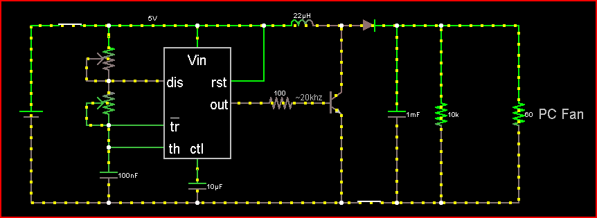

I have made revision to my circuit. However i am still not getting 12v. I have found an inductor with a marking of 220k so i think it is 22uH which i am now using. i have also changed the 10k resistor with a 100 ohm. The transistor i'm using is a C2335-R and the 60 ohm resistor simulates my fan. The output frequency of the 555 is approximately 20khz. What can i do to increase my output voltage further:
capture-png.50898
Your inductor is way out. Try one with about 470uH (471 markings) or 680uH.
Your circuit also does not have good control of duty cycle, you should use a 555 circuit that has diodes on the charge/discharge paths so you get a much better control of duty cycle.
The 2SC2335 is a high voltage power transistor. It saturates poorly and has low gain.
The 100 ohm base resistor provides a base current of about 28mA and the saturated collector current might be 180mA. Then the output might be only 75mA at 12V. But your 60 ohm load needs 200mA at 12V.
I don't see a part number for the diode. It should be a Schottky high speed one.

Thanks for your help. I will buy a 310uH inductor tomorrow. Looking at what Ben7 has said is it possible to change my transistor to a MOSFET easily. To get the more accurate frequency's I will be looking at a PIC chip to control the voltage possibly with a feedback input.
Ben7 is there also a way to make it much more efficient so i don't get so much heat output ~5 times as much current seems quite high given the calculation of:
P=I*V
P=0.2*12
P=2.4W
I=P/V
I=2.4/5
I=0.48A input in ideal conditions - I realize there will be losses but i would be loosing a lot in heat
The transistor or Mosfet in a boost converter operates cool because it complerely turns on hard with a very low voltage across it then it turns completely off with no current. If it switches on and off very quickly then it spends a very small amount of time with both voltage and current which causes heat.
I think you calculated how much the load will heat.
when i ran my circuit last it was rapidly gaining tempurature. It got very hot in less than a minute and it was using anbout 0.9A. Why could this be then?
0.9A from 5V is only 4.5W. The fan probably used most of it. You used the wrong transistor because it is rated for a very high voltage instead of low loss.
