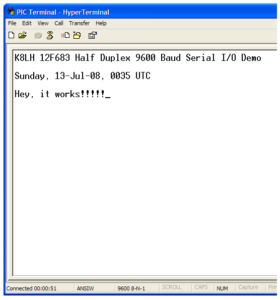

Anyone interested in seeing BoostC code for interrupt driven bit-banged 9600 baud serial I/O on a little 8 pin 12F683?
This is a novelty project with no practical application I can think of (it ties up interrupt capability). I just wrote it to evaluate BoostC interrupt "overhead" which is pretty high.

Hi Mike,
You seem fascinated with getting the most out of the least :)
I'm guessing you let boost handle the context save? How much overhead, compared to the same example you did a while back, in assembler? How much ROM did you need for the app?
At least this 'little slugger' has some stack space, but given your comments above, would you say it is worth using boost C, or any other C, for these little chips?
Oh, I think it's worth it. The code is just so much more readable. I suspect all of the C compilers for 12F' and 16F' devices are going to have caveats to watch out for.
The useless BoostC ISR overhead was about 4 words and 5 cycles. Not much to complain about, really. I did ask the developers why they waste cycles and include code to manipulate bits 3 and 4 of PCLATH on 12F' and 16F' devices with only a single page of memory but I never really got a good answer and I suspect it's just too much work to go beyond using a "one size fits all" library of output code segments. Anyway, I'm not going to complain because they did a pretty good job of coming up with something that's very usable.

The program is attached (with a .txt suffix).
