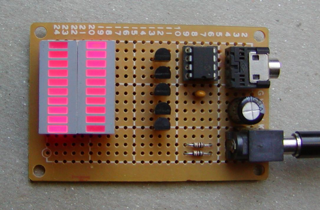

Sorry about the picture. I tried several different shots, lighting, shutter speeds, etc., trying to show off the smooth fade from about 10% to 100% brightness but never did come up with a good shot. I even tried it with red LEDs (below) but "no joy" as the color is all washed out.

The green LEDs look good on my monitor. :) The brighter ones are a little washed out but the effect is perfect.
Photography is a lot better than I would normally do. :eek:

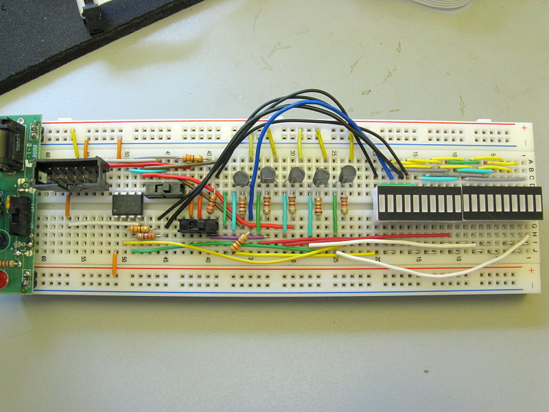

I breadboarded Mike's creation, going by the schematic he provided. Holy hell!!! That's a lot of wires to squeeze onto a little breadboard! As you can see, I gave up keeping it neat after a while. Just too many...
The switches switch GP0 and GP1 between programming mode and run mode.
But it doesn't work!! :confused: Some LEDs light, but no action.
Mike! How accurate is that schematic? It doesn't say the resistor values, so I did some educated guessing.
Sorry you're having problems.
Transistors are 2N3904 NPN. Most people see that they're sourcing drivers and assume they're PNP (because the drawing is so fuzzy).
I originally used 510 ohm base resistors and 20 ohm current limiting resistors on the rows but the board in the picture has been taken apart so many times that there are NO resistors at all at the moment. Bad practice I know. It just shows how forgiving this stuff is...
Let me know how it goes?
Mike
