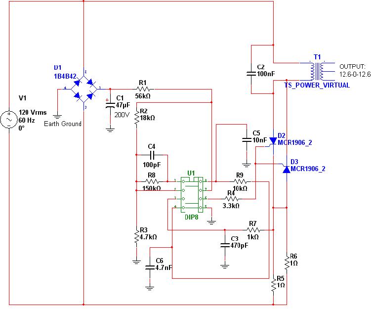

So, if I connect the UC3843 to a circuit similar to the one shown in figure 33 in the data sheet, can I boost the output current of the transformer, without boosting the voltage? I will attach a schematic once I finish it.

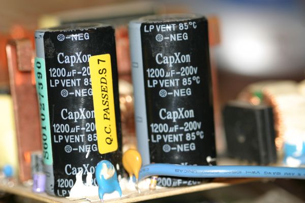

And if it's not too much trouble, I found a capacitor in the same power supply, I don't know what it's capacitance is, or it's voltage rating. It reads 400WV (how many volts is that?)
330MF (is that mega-farads? or milli-farads?)
Here is the schematic that I came up with.

If I understand, the power supply unit is for a radio. It is better Not to use Switch mode controllers, either current mode or Voltage Mode as you are likely to suffer the QRN created by the supply itself.
How did you get 34V or so Unless you would have used end terminals in a bridge formation?
when you say the current demand, what are the voltages derived, I understand that you have used three LM7812 regulators.
Generally you know, a full wave rectifier is preferable for higher load demands instead of bridge. As such, I would suggest that you may use full wave rectifier using 3 amp schotkey diodes for reducing forward drop and thus the output DC would be higher. After filtering you are expected to get around 17.8 on no load, and while on load, even if you consider 0.4V Drop for the schottkey diodes (each half cycle, only one diode need be considered) you are safely getting at least 13.5V leaving the balance for the copper loss.
Now you might use LDO regulators instead of normal ones to give you 12V and under load distribution method, three such can safely serve your needs.
It looks to be a pretty standard SMPSU IC, and I've no idea what the two SCR's in your circuit are doing?.
You should be using an FET as shown in the datasheet, and of course a custom made SMPSU transformer - this would be in addition to (or entirely replace) the existing PSU - you can't 'boost' it.
However, you would be FAR better off redesigning the original circuit correctly.
Doesn't the VA rating of the transformer limit the output? You can't get more amps from thin air, only what the transformer is capable of.
Under optimization and use of modern components, the losses could be minimized.Thus we can get full efficiency and as transformers are 10% over equipped as safety margin compared to design spec, i feel this could be possible.
If a 120V to 12.6-0-12.6V transformer has to be used, one can always wire the output windings in parallel and use a bridge, so that more current can be expected of it. this is limited by the core dimensions, though. as I have already suggested , it would be better if we can use schottkey diodes and LDO regulators, for a radio power supply.
I hope we can still manage to get a load of at least 40% in excess of the designed capacity.
OK, first let's look at your questions here:
The 400 WV means the capacitor is rated at 400 WV (Working Volts) on some caps you may see for example 400 WVDC (Working Volts Direct Current). It is simply the maximum rated voltage the capacitor should work at. The 330 MF would be a 330 Micro Farad cap but is generally written as 330 uF so I can't explain their naming convention on that one.

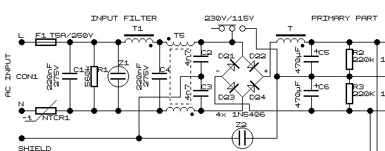

Attached is a partial image of an older 200 watt ATX PSU that shows the power in. Note C5 and C6 the first image. Those would be the equivalent likely of what you are seeing. The second image is another pair of the high voltage caps used in an ATX power supply.

Now let's look at what Nigel had to say:
Note Nigel's reference to the transformer. You can't make a silk purse out of a sow's ear. However, if you want to learn then have at it.
This brings us to why do you think you need more power?
On another note, you would do well to replace your 4700 uF cap with one rated for 50 volts as you are about on the limit with the 35 volt flavor you have.

Technically 300MF is 300 Mega Farad. Although I'm pretty sure everyone here knows that this is not the case here (nor is it rarely the case).
Well let's see a one farad capacitor is a pretty big capacitor so I figure a 300 Mega Farad is really a big capacitor. Maybe bigger than a bread box or maybe even bigger than an elephant? :)
Exactly, I was just pointing out standard SI notation and the fact that it isn't used here, confusingly (or maybe not so much in this case).
I knew that, I was just pitching some humor. However, Nigel mentions a pretty cool capacitor in this thread. Talk about a serious capacitor!
I have been trying to recall if I have ever seen a capacitor labeled MF and I want to think I have but can't recall when. I want to think it was some time ago.
Ron
Back in the OLD DAYS of Tube Circuits, MF was use as the symbol for Microfarads.
And uF Didn't Exist, or very Rarely so.
Multiply the volume of the one farad cap by about 300 million to get the size. Say 1 farad is a conservative 10 in³, then 300 MF would be 3 billion in³ or a cube about 120 feet on a side. Yes, that's rather larger than a bread box, or an elephant...
That was it! The old days of tubes (valves). Additionally they were condensers then. Though my old Radio Handbook ninth edition (the first edition was 1942) so maybe the 50s uses uF but also the term uuF was used for pF. Funny how things have changed over the years. :)
Nice going crutschow with working it out.
