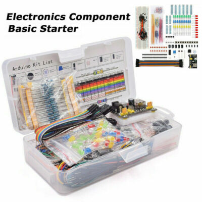

Try searching "assorted component kit" on ebay & amazon, then pick one that seems appropriate?
There are dozens of different kits & variations available, eg. a couple of examples:
ps. Whatever you get, if the resistors are (or have been) in bandolier strips, cut 6mm off each lead before using them in a breadboard. The bandolier tape can leave adhesive traces on the wires which can mess up the breadboard contacts. Either that or clean the wire ends with solvent before their first use.
