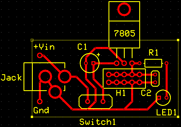

Here's a cool little power adapter I saw someone selling.
Granted $15 is a tad bit silly for a jack, regular, cap, and switch, so I made my own with a generic Radio Shack solder board. :) You can plug a wall-wart straight into it. I also added two posts for alligator clips. It works rather well. I would definitely recommend making a few. At least one, so you don't have to waste time fiddling with getting power to your project boards. Just grab it, put it in, and you're ready to work. :)
Steve: Yea I might get a switch..if I can find one if radio shack.
bonxer: that seems cool...seems like an interesting future project? Do you have a schematic?
How about something like that? It's got a jack to plug straight into, it's got a +Vin pin and a Gnd pin to connect alligator clips to input power to it. Plus it's got two rows of header pins to plug into the busses on the breadboard. It's kinda bad the way I have this drawn, with the ground snaking around everywhere like that. This was just a quick diagram.
Also if you will use an adapter, one of those that have 3, 4.5, 6, 7.5, 9 and 12 V out, you need measure the voltage because not always is what is in the text, also you will like to put a capacitor in the terminals, at less that work for me in a little project that I was having problems, and where solucionated putting the capacitor there.
