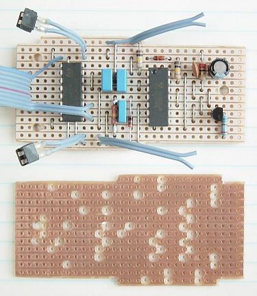

Why not use veroboard? you know, the stuff with a bunch of holes in it.

I would guess that tracks with a 0.1" spacing and 6" long would have up to 47pF between them. A pcb or Veroboard would have about 2pF.
The strips on a Veroboard are cut with a drill bit to a short length.
I used a drill for many years, but it's FAR easier to use the correct 'spotface cutter' tool which the board manufacturers sell. They are only cheap, and well worth having.
I use my drill press to cut pre-marked tracks. Then I can cut 30 and sometimes 60 in only a minute. :lol:
