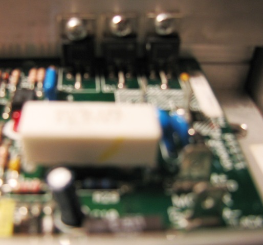

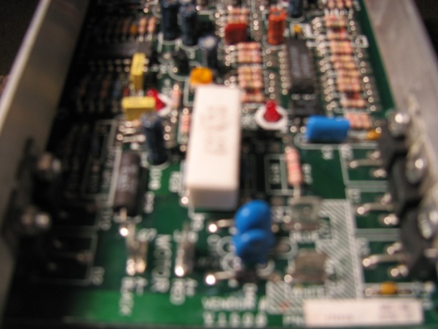

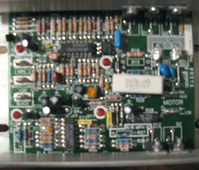

Thanks CadStarSucks for the Digikey.com info. It looks like the route I will go. The motor originally came off an old treadmill. I still have the electronic circuit board that went with it. I remember some of the sensors had went out a few years ago. I took a picture of the board because I am going to assume what I need is on that board already beings it run off house current when it did work.
I am pretty sure the bridge rectifiers are the black things heat sinked to the sides. They are 5 of them. Are they run in Parallel? I am not sure which part is the capacitor though. Is it the white porcelain looking piece?
I have a google education on what I have learned so far about electronics so bear with me. :p
Those are probably FETs and Duo-diodes.
That looks like a 5 watt power resistor to me. Hard to tell from the blurry pic. Can you post a better one?

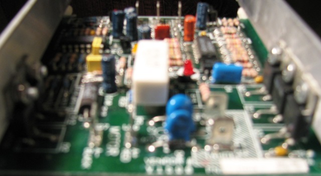

Thanks kchriste,
I hope this will help better. I also added the pic of how I would wire the rectifier and capacitor together. So was I right to assume the rectifiers are the black things heat sinked to the side?
(1) Would I parallel wire them?
(2) Would I use all 5?

In your pictures the capacitors are the tall 'can' shaped items with a silver coloured top and a stripe down one side.
The heatsinked items are not rectifiers.
Rectifiers come in various shapes, but they all have four legs.

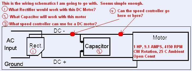

OK, Here is what I am going to go with (check out attachment)
Looking at the picture:
(1) What rectifier would I use for the Motor Specs listed.
(2) What Capacitor would I use?
(3) What Speed Controller can I use?
(4) Where would the Speed Controller go? (I labeled 2 spot on the schematic)
I see no capacitor. It looks like you have a phase drive there. I am not sure as there are not enough power components for a PWM drive assuming those diodes are the bridge and I can not make out the component references.
I looks to me like you have 2 diodes and 2 SCRs for a phase controlled bridge and a freewheeling diode across the motor. It would make even more sense if you look and found they are all the SCRs with three being used as diodes.
For a PWM you would need 6 in that configuration. If they were dual diodes there would only be 4 as there would be 2 for the bridge, an IGBT, and a freewheeling diode. And you would need the capacitor.
The "white porcelain looking piece" is an inexpensive power resister use for over current protection.
Dan

Ummm...there is no tall can shaped thing large enough to be THE capacitor. Only small ones there tho filter the the power for the control circuit.
There is no main capacitor in his piccys. It would be on the order of 1.5"x1.8" not 0.3x0.5".
Diodes only have two legs, duals three and bridges four. I will maintain that he has 4 SCRs in a controlled bridge.
Dan
