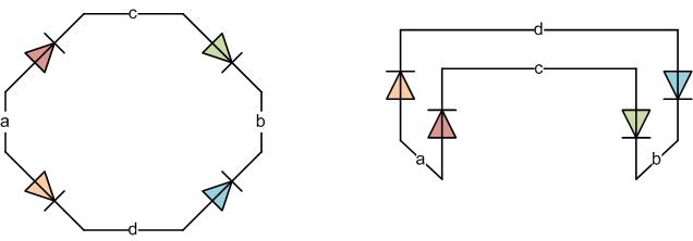

Confusion reigns supreme !! I'm building a circuit which starts with a bridge rectifier and the schematic shows the diodes in typical triangular formation but I thought I'd be clever and arrange them side by side - takes up less room on the PCB. I did it properly, drew it first then laid it out and now I've looked at it so many times I've talked myself out of it.
Please would one of you geniui look at my sketch attached. The top is what the schematic shows and the bottom is what I've done.. ..

Hi Ian
Yes, I probably would if I was crossing the river, but I'm actually using 8 1N5400 diodes because that's what the schematic says I should use .. :) plus I don't have a 'bridge' ..
I was just hoping that a genius would take one look at my sketch and say ' Yes, MM you are right !' Remember, I'm only a poor novice ..

Music, your layout is correct.
Your confusion comes about because as drawn, points C and D are "swapped over" as drawn.
This makes no difference electrically.
Don't call me a genius, you novice! :)

Yes, you have it right
It makes more sense to lay them out as you have shown...
That's what I thought, but if you haven't done it before, it's as well to double check, and the more I looked the less .. .. well anyway ..

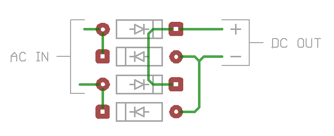

When laying out a bridge on a PCB using discrete diodes, I tend to lay them out like this.
This way, no wires (traces) need to "cross".
