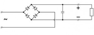

I am a novice with electronic circuits, but attempting to expand my knowledge. I am trying to convert 14VAC to 12VDC with about a 15A load on a riding lawn mower for LED lights. I installed a 200V 60A Bridge Rectifer (NTE53016) and my output voltage is only 4VDC at full rpm on the stator. I also installed a 4700uf capacitor across DC + and -. Am I correct in assuming my bridge rectifer is too large for my project? Would a GBU1510 be a better choice to achieve my 12VDC output? Kind Regards!

Thanks so much for your input!! I have the 14VAC rectifier terminals wired to frame and the other to the AC output of the stator. DC output of the rectifier - to frame and + is reading 4VDC. 4700uf Capacitor between + and - DC output. Can’t envision anything missing in this circuit.....
Sure! I think I had a bad ground connection. I’m getting 12.8VDC across the DC output term. Of the rectifier now. I am still getting flickering of my LED lights even with the 4700uf cap. Wired as seen in the diagram. Wonder if I need a bigger cap for this circuit??

your schematic does not match your text description above. Above you say that one lead from the AC source is connected to the chassis AND the negative output is connected to chassis (ground).
AC input from stator to AC term on rectifier. Other AC term on rectifier is connected to chassis. DC + output on rectifier is connected to LED light +. DC - output on rectifier is connected to - on LED lights. Please forgive my inexperience. Thanks very much!!

I think I resolved the voltage issue by repairing a bad chassis ground to the AC term on the rectifier. I am getting 14VAC input from the stator and 12.7VDC (No Load) or so at full RPM on the output side of the rectifier. I am still experiencing a flickering issue with the lights even on DC current. The lights operate at full intensity when at full RPM.
I am running about 130 Watts on my LED lights according to the specs on the packaging.

The capacitor is too small. I don't know what the frequency is, and you need to know the frequency to know what size of capacitor is best, but too big won't hurt. If you go to a really huge capacitor, the lights will take a noticeable time to hit full brightness when you start the engine, and will take time to fade out when you stop the engine, but you would have to spend a lot of money on capacitors for that to happen.
My rough guesses are that the alternator has 4 poles, and the idle speed of the engine is 1200 rpm. If those are right, the frequency is 40 Hz. With the full-wave rectifier, you have about 12.5 ms gaps between pulses from the rectifier, and the capacitor has to provide the current during those gaps. If you want to get 10 A with a voltage drop of 2 V during the gaps, then you need a capacitor of 62,500 uF
The capacitor size needed is proportional to the current, and inversely proportional to the number or poles, the engine speed and the voltage drop you can accept.

Just to stress a point Gophert made earlier, in case it was not clear:
If one side of the AC input is grounded, the DC must be totally floating - no ground connections anywhere, direct or indirect.
(Or vice versa - for DC to be grounded, the AC input must be floating).
If you have grounds or any kind of interconnection at both the AC and DC sides of a simple bridge rec, it forms a short across one of the diodes and shorts the AC supply on one or the other half cycle.
