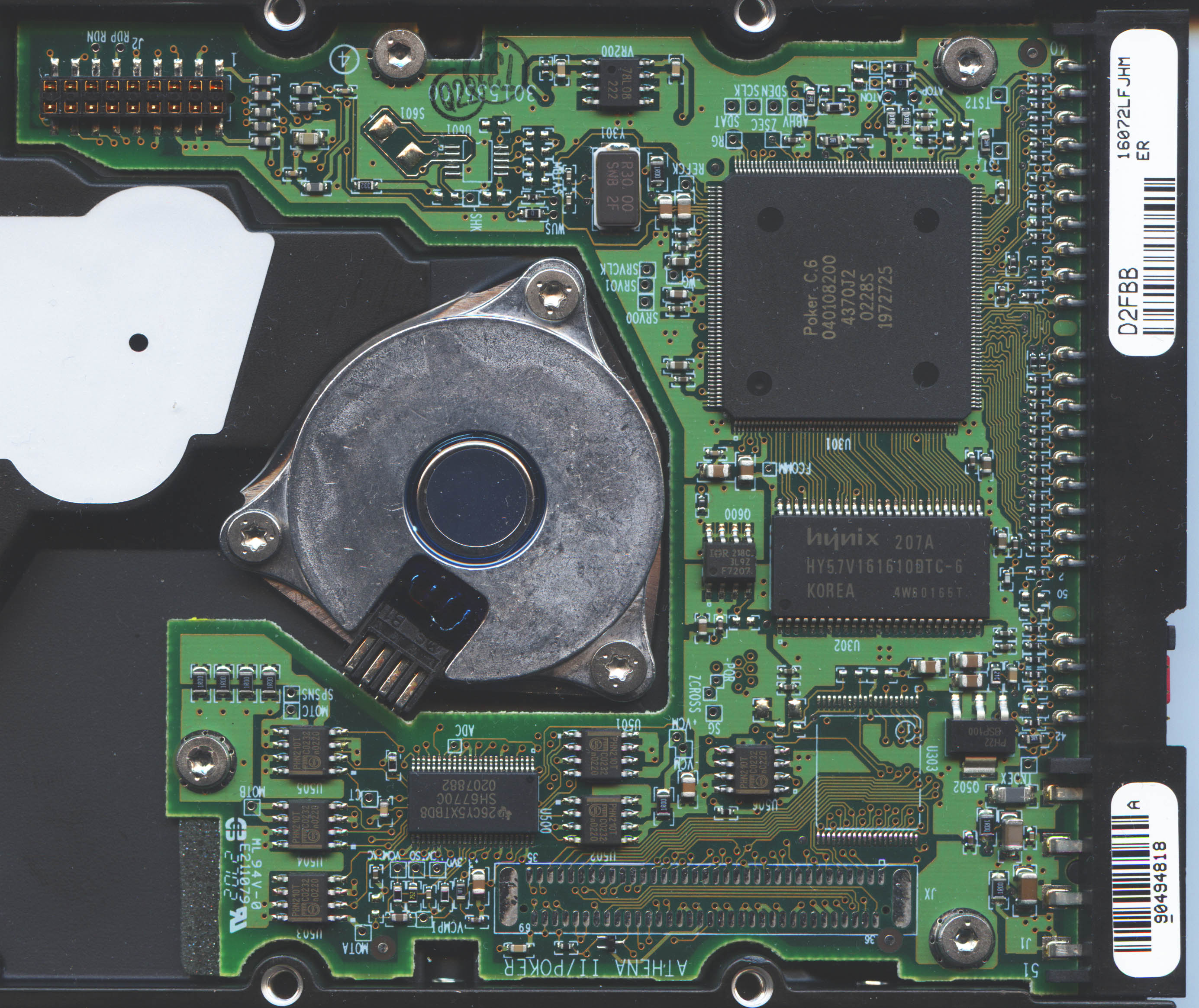

OP, here is a PCB board for your 541DX that you could swap with:

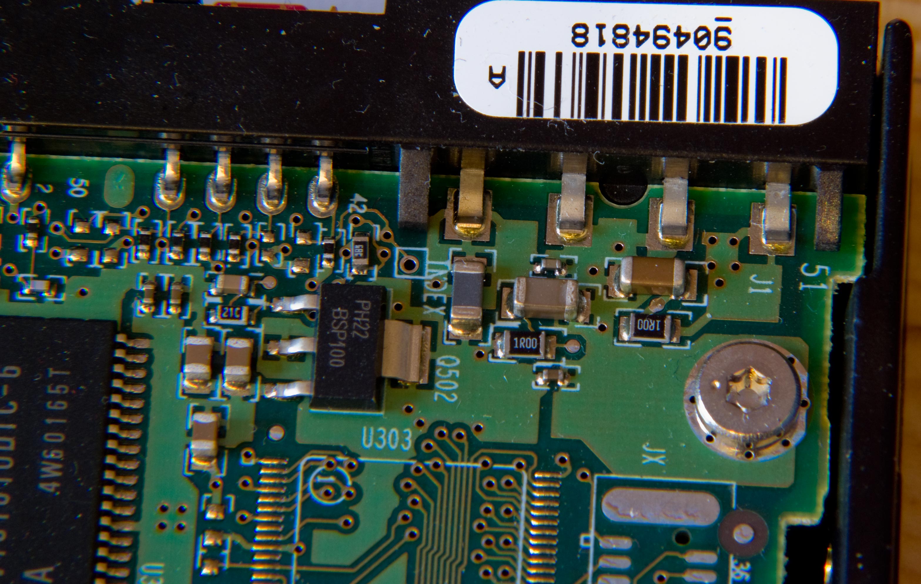

If you could upload a close-shot picture of your HDD circuit board (close to the PSU connector), maybe we could help you to find the possible blown fuse. This have to be a really clean picture though.
here is a pic, let me know if you need more area
Check those 2 1R00 resistors, then the ferrite bead (the gray thing next to INDEX label).

the 1 ohm resistors are measuring more like 21-22 ohms, I'm currently working on an image of the whole board (didn't you know you could do a panoramic image of a circuit board ;-) )
Good enough. I guess it would be good to see the other side of this PCB. Seems pretty easy to remove the controller board. Remove all screw, then gently remove the PCB. Look how the motor is connected to it.
I would probably suggest to check all those ferrite bead and all 0 ohm resistor/jumper, check voltage at VR200 output (should be 8Volt) and all other test point. But yeah... is there voltage everywhere if only connected to an ATX supply??? can't tell myself.
