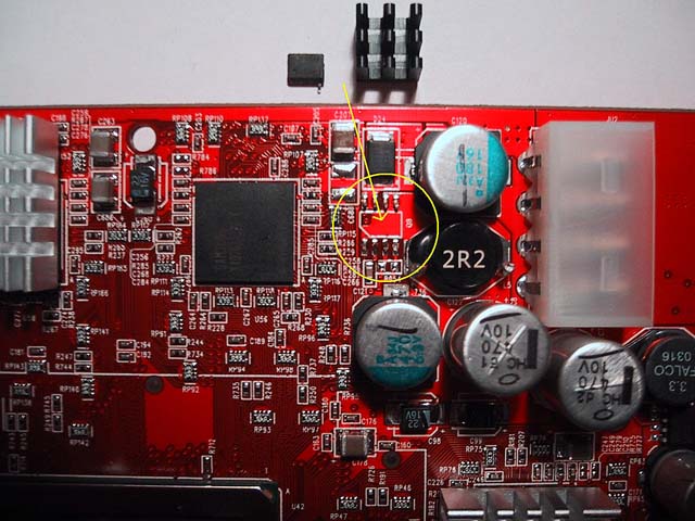

I had an accident when installing my Radeon 9800 Pro videocard in my computer. I ripped of a small chip with a heat sink attached to it. I think it is a MOSFET. It has 8 pins and marked:
P33AB
FDS or FOS (hard to see)
6912
Now I just have to find a company that have this in stock and is willing to ship to Norway. I would appreciate any help in this matter.

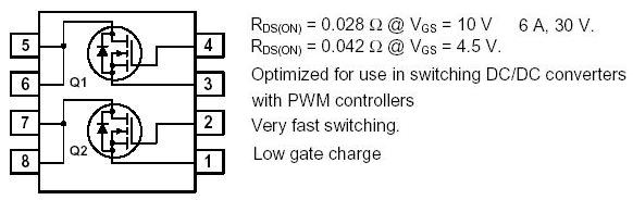

As i see this is a PSU section. The component is a dual MOSFET from Fairchild FDS6912.

Yes I got the sample. I requested 2 ea. just in case I should overheat it and ruin it when soldering it back on. It took about 5 days shipping it from the Phillipines to Norway with FedEx, which Fairchild paid for. :D
A friend of mine, who works for an electronics workshop, soldered it on. Everything works perfectly as before the accident, and best of all it cost me nothing...

Try this chip, low budget and works
Hello. I had the same problems on my card. Today i built my card, four hours of gaming Farcry and the card always work :lol:
The chip i take was the "IRF7313" from www.conrad.de (order number: 16 24 52; 0,78 cent each) It has the same specific electrical properties like the FDS6912 from Fairchild .
(Some small deviants: Turn-Off Delay Time, Turn Off Fall Time, Gate Treshold Voltage...see fact sheet) But, it works!
