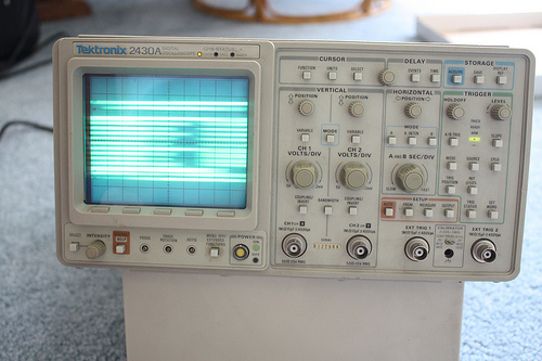

Hi All,
My broken oscope just arrived and I'm trying to figure out what needs to be replaced. Looks like it is out of focus. Hopefully it doent have any other problems, but I guess i'll find out once I get the display fixed.
Any idea where to start? I'm thinking it might be something with the high voltage board? I have another dead 2430A that I could swap with, but the board layouts are different. So I'm not sure if they are interchangable?

Yeouch! Looks nasty. ;)
The vert timebase is oscillating, maybe the horiz too, and there is a very obvious lower freq noise component shown by the darker areas...
I bet it's got bad caps in the PSU and the PSU rails look more like AC.
