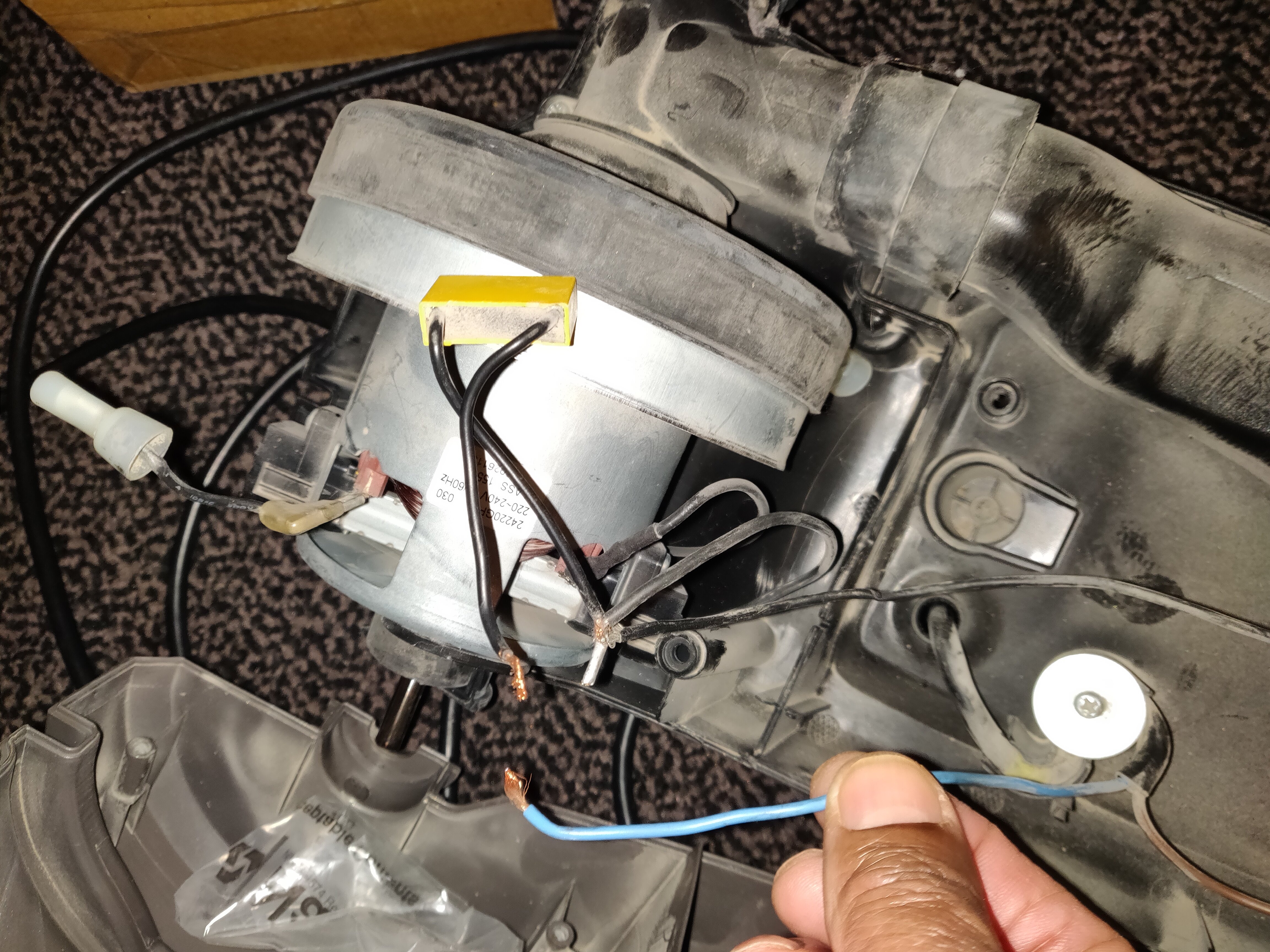

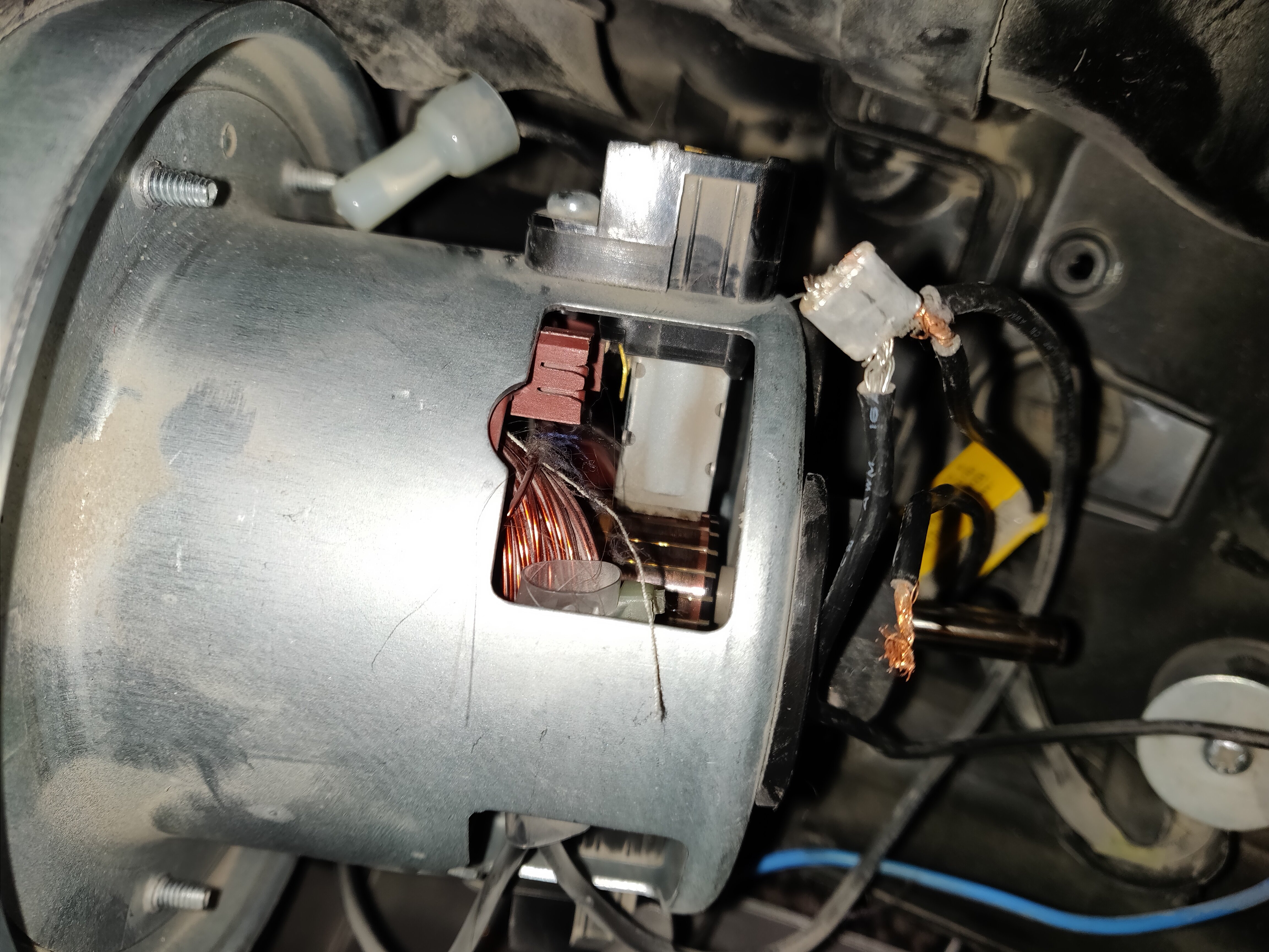

I have opened up to see whats wrong and can see the wires but dont know where they should connect to. I have taken it to a repair shop but they say as I have opened it they wont fix it. Can anyone suggest how these wires should be connected?

I can't even recognize the parts.
Usually, there is a motor (2 wires)
Power in (2 wires)
Switch (2 wires)

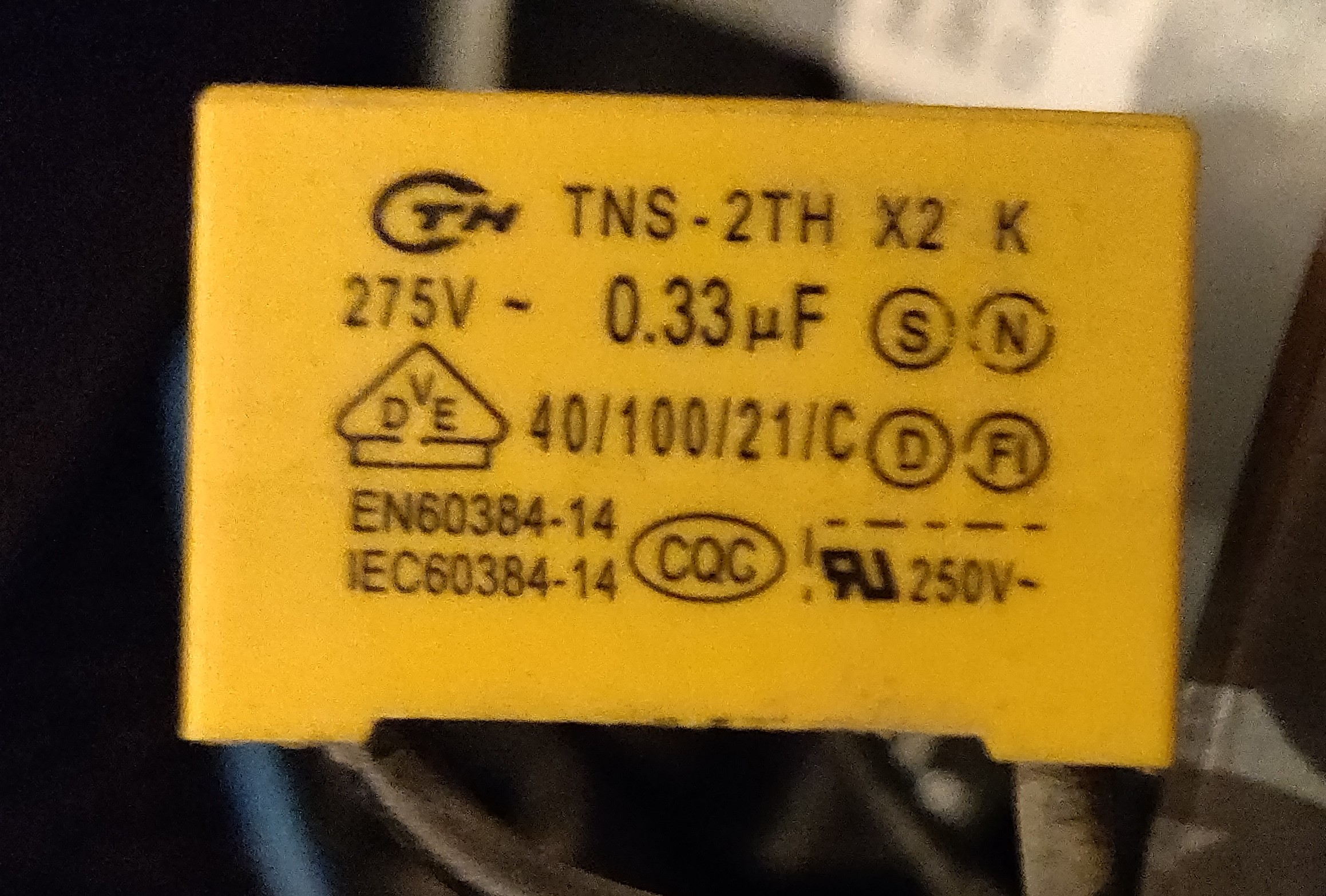

The yellow thing is a capacitor. What is printed on it?
A low value like 0.1 uF could mean across the switch or across the motor.
if the motor then it helps eliminate RFI. If across the switch, it's to surpress arcing across the switch contacts.
Most vacuums use universal motors and have brushes.
One of my vacuums has a "dirt indicator". It glows when it's actually picking up dirt.
The power cord can be white black and green or brown, blue and green yellow stripe. See: https://www.ledlightexpert.com/Brow...is-black-and-hot-and-which-is-white_b_13.html
The switch goes in series with the black or brown wire.
Thanks for replying, I have attached an image of whats written on the capacitor. The disconnected wires are black from the capacitor, and a blue wire. I will have a look at your link in the morning, thanks

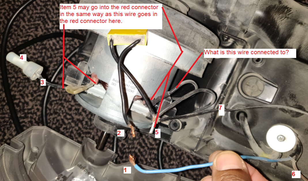

Look at my annotated version of your picture:
Within the limits of what I can see on the picture...
1 is the incoming neutral wire from the mains.
6 is the incoming live wire from the mains, which goes to the switch (out of picture).
7 is the live wire to the motor from the switch.
3 is one connection to the motor.
5 is the other connection to the motor.
Wires 1, 2 and 3 should be connected together.
This will put the mains live (7) to one side of the motor (5), and mains neutral (1) tot he other side of the motor (3),
and the yellow capacitor (which is an X2 rated type) will connect in parallel with the motor.
The lump of white plastic (4) on the end of wire (3) is an insulating sleeve, and should be removed before connecting 1,2,3 together.
When the connection 1,2,3 has been made, it must be insulated well.
Similarly point 5 must also be well insulated.

Wire [7] in Jim's notes has a kink in it, just where he has labelled it.
I suspect it is supposed to fit in the notch just below it in the plastic rib, but has been trapped out of that in the past.
Make sure the wire core has not broken there, and that the insulation is OK?

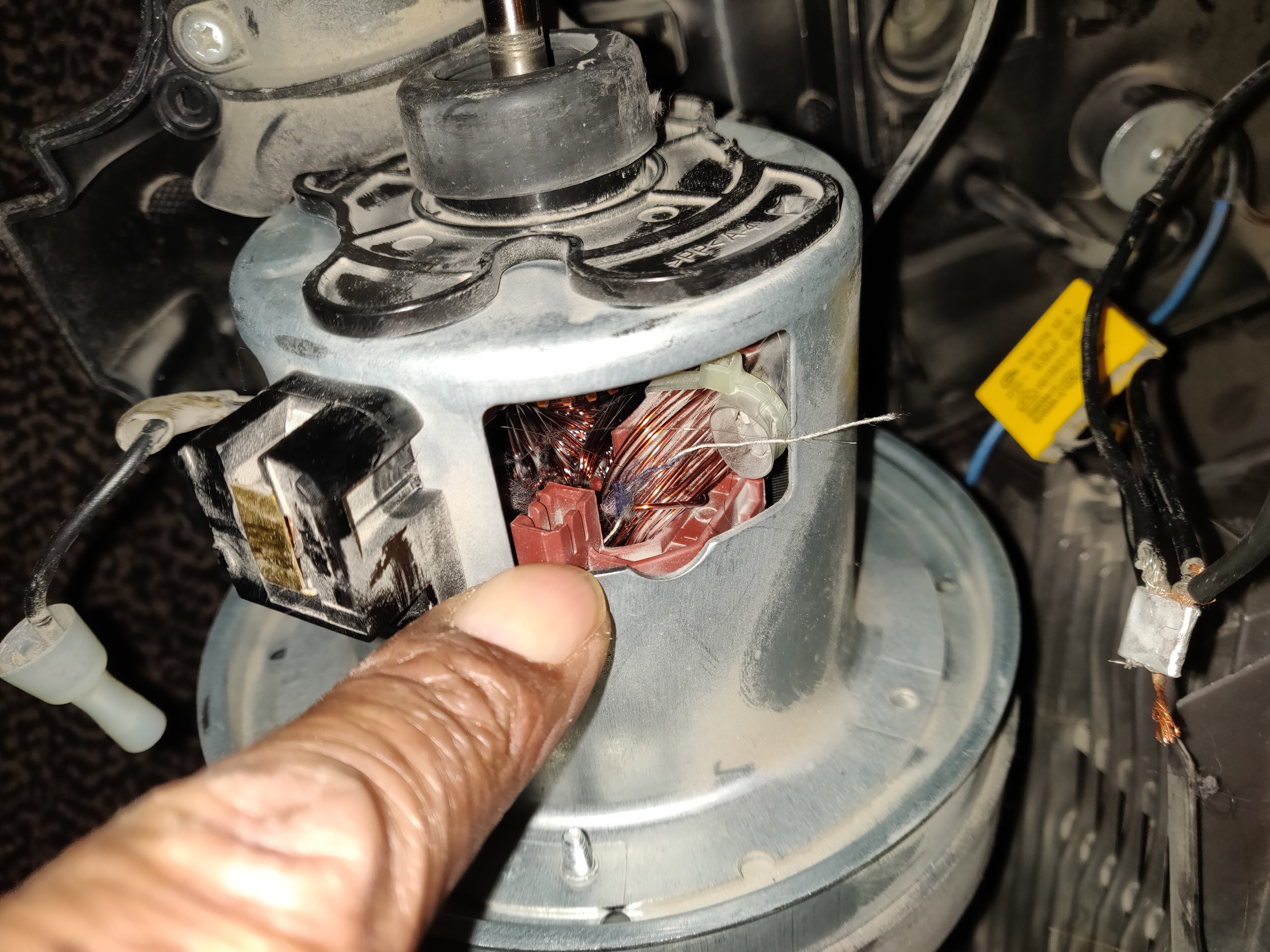

Just one more check please. Just inside the motor casing I can see this brown connector, should is this missing something?

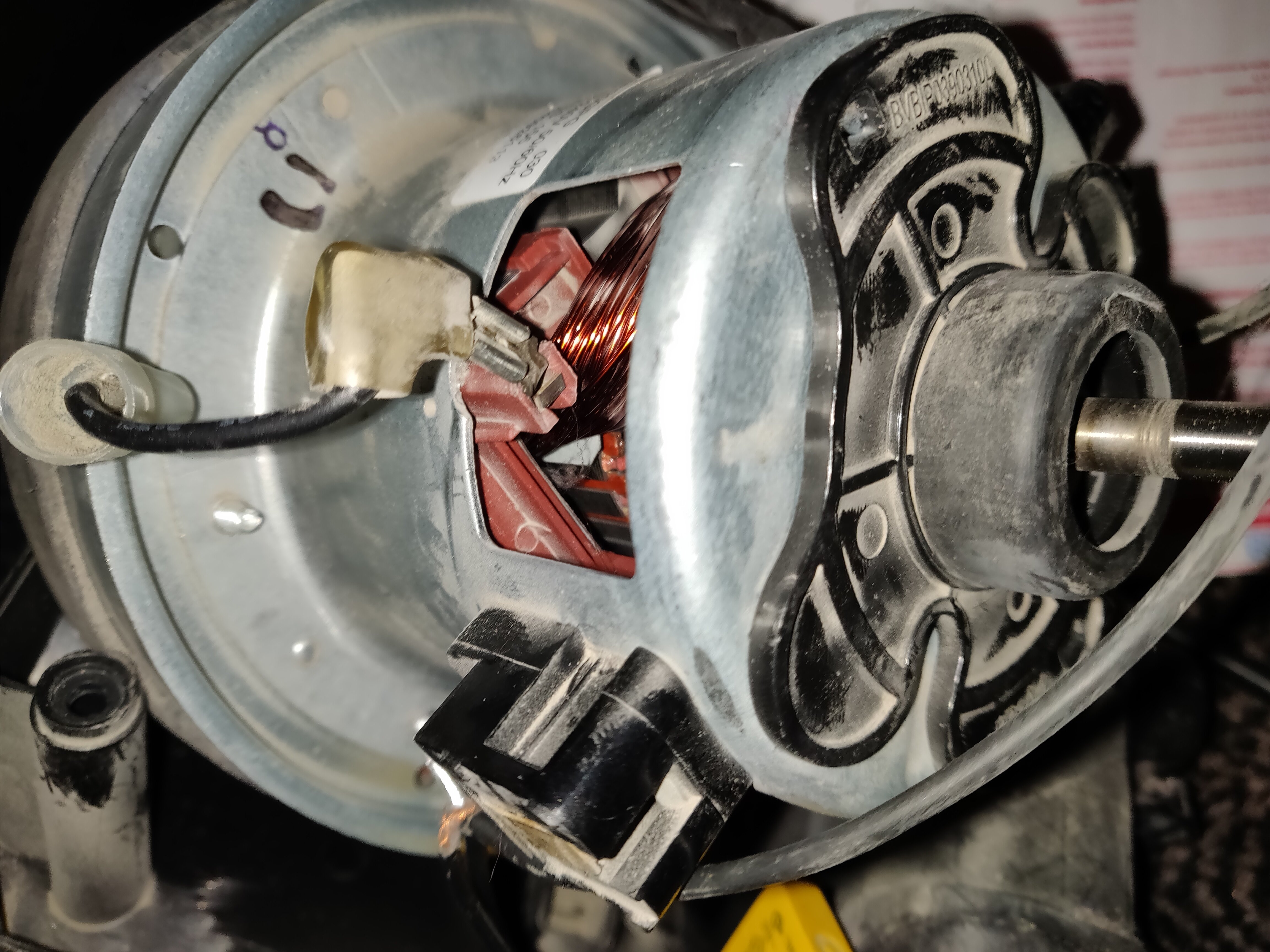

No mate, it was working right up until it wouldnt power on 2 weeks ago. We've had it about 5 years. Its quite possible nothing is supposed to be connected there but I am checking as the silver shielding may have come out of there. It could be ive disturbed somethings while opening the case.

One comment I have, the commutator looks a bit dirty, are the brushes making good contact?
Look at my next picture:
When I turn the motor it all sounds as if good contact is being made. That connector is attached as in the new uploaded picture.

I originally thought that this was a shunt wound motor, looking at the pictures I now think that it may be a series wound motor.
As a result, I think that my original assumptions as to the connections of the disconnected wires may be wrong.
Without seeing the motor on the bench in front of me, I cannot make any further suggestions.

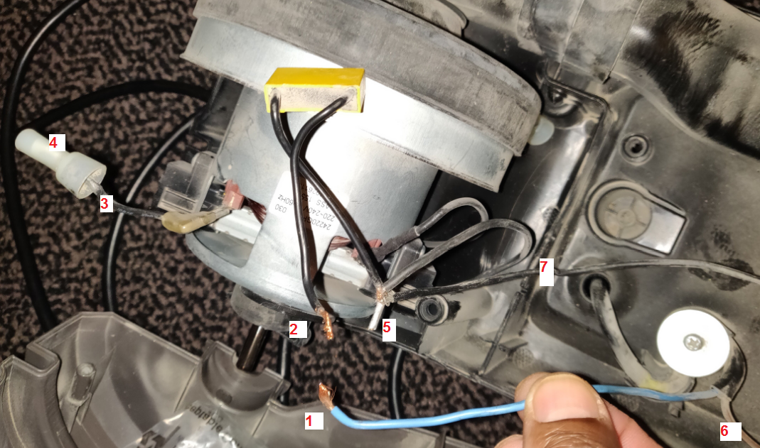

I'd say Jim's original answer in post #4 was spot on.
Wires 1,2 & 3 need re-connecting.
The nylon object (item 4) is a mass-production wire splice, just a metal tube in an insulating sleeve, crushed on a twisted wire connection to hold them together.
Over time with vibration or for whatever reason, wires 1 & 2 have pulled out of it.
Item 5 is presumably the metal inner from another of those, that has lost its insulating sleeve.
I'd tidy up the ends of wires 1,2 & 3, twist them back together and use a single section of nylon "choc bloc" terminal over the end and tightened securely to give a solid connection.
Then tape up that and the other junction, item 5.
Re-assemble it and try it!

Fantastic! My connectors arrived today and ive connected as per Jim and yourself and our vacuum has fired up again. Many thanks for your helps.
Wow, that is good to hear.
