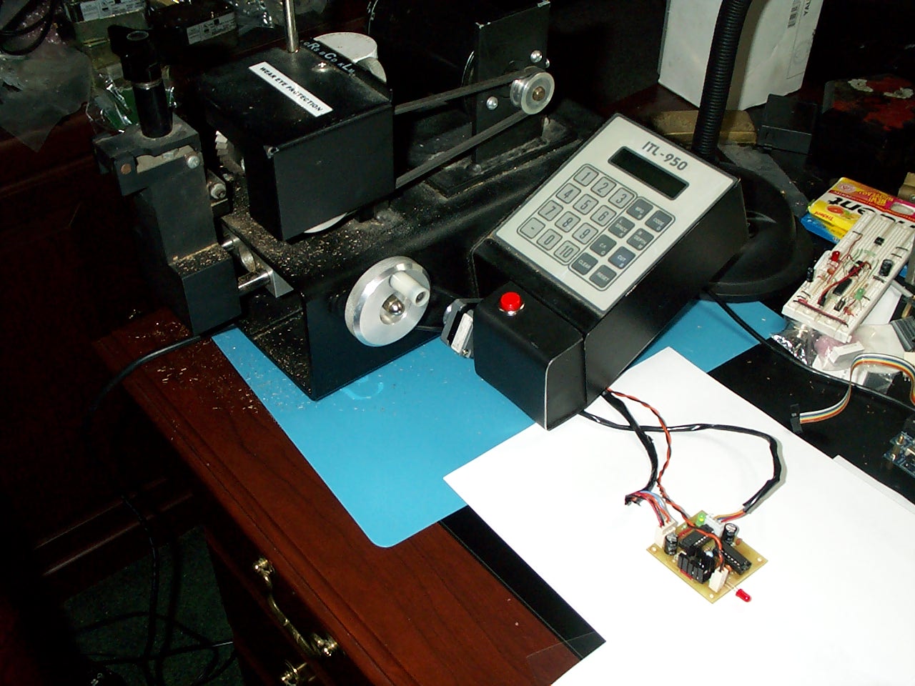

As for using a 12V stepper -- I don't understand why? The reason I chose a 3VDC stepper was because I could run it at 12VDC (which is the voltage that I have to work with -- I don't have the luxury of designing a 48VDC power source -- I have to work with what the machine offers) and limit the current to get speed and torque (I'll have to show you a video of what it does -- attached is an image though). Well, that, and it was readily available at Sayal! Again, I am a noob, so correct me if I am wrong, but you'll get nowhere near the same speed / torque from a 12VDC stepper, supplied at 12VDC.
As a final note, the stepper itself is not causing the brownout -- it is a DC motor (regular motor) that turns on to start the cutting wheel of the key machine. My 12VDC source is being supplied from the same source as this motor.

The key machine itself provides the 12VDC -- it's a 110V machine which supplies (through an internal transformer) 12VDC @ 10A for the DC cutting motor and internal stepper.

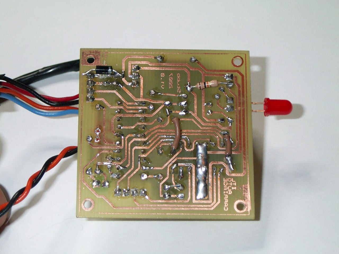

I would disagree - D4 is pretty well essential, as is a much larger C5 - this allows C5 to power the circuit if the supply dips, and the blocking diode stops the external circuitry discharging C5. It's a standard method to help prevent high current surges (from motors etc.) crashing the PIC.

A 470uF 35V cap was added (C5) on the 12VDC source, before the regulator -- the trace was then cut on the bottom solder from pin 1 (12VDC) of J1 to C5 -- a 1N4004 (that's the smallest one I had on hand) blocker diode was then soldered across the gap from J1 to C5 (+).
I started with a 470uF (up from a 100uF) -- I don't know what size is actually required, so I guess one day I'll have to reduce the cap until it browns out to see my threshold.
Images are attached of the mod. (And the other resistor you see on the back in a pullup I forgot for the push button! Doh!)
