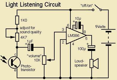

where did you find that schematic?
found a similar circuit
searched LIGHT LISTENER"
but no 741 op amp?

The Light Listener circuit you recently posted is almost the same as from the Mini-Notebook I posted but it uses an LM386 power amplifier instead of a 741 opamp.
Your latest schematic from DIY-Electronics projects is from India? Most circuits are simply copies from other websites. Many DO NOT WORK. It even has an LED project of mine and they did not ask for my permission.
The last two circuits you posted are missing a 10 ohm resistor and 0.05uF capacitor in series to ground at the output of the LM386 that are shown on every schematic in the datasheet that keep it from oscillating at a high frequency.
The circuit from India is missing a coupling capacitor from the output of the wrongly biased opamp to the volume control so IT WILL NOT WORK.

The first circuit I posted is an audible light listener. If you hole a tv remote in front of the photo-transistor you can hear the pulses from the remote.

The "Light Listening Circuit" with only an LM386 power amplifier IC is much better because it can hear the clicks from a TV remote and can also hear voices and music if you have an opto modulator. The LM386 should have the 10 ohm resistor and series 0.05 (0.047uF) capacitor added to its output to ground as shown on its datasheet.

The circuit with the old 741 opamp and LM386 has the LM386 with a gain of only 20 because a capacitor is missing between its pin 1 and its pin 8.
Removing the opamp and adding the capacitor will make it work much better with a gain of 200.

I basically connected the photo transistor directly to the lm386 but failed to add the cap.
it appears to work pretty good as is but will add the 10 ohm and cap to the lm386 output.
