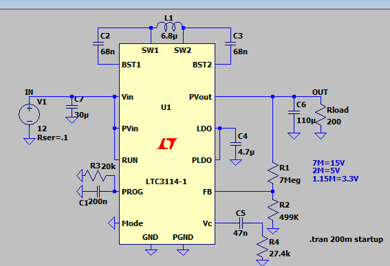

I think you want 1A. Try this. You might want LTC3115 for more current. You should set "under voltage lockout" to 4.5V because it is hard to boost low voltage up to 15V and this part will try to work at 2.2V and should be told to not start working unless the voltage is 4.5 or 5V
--edited--
I am playing with the above. It is hard to boost from 5V to 15V@1A. It takes 3A at 5v to get 15v at 1A and this part does not like 3A. So the ltc3115 is better.

The simulation result of the circuit is excellent, but the price is very high! Really very expensive. Do you know a cheaper solution?

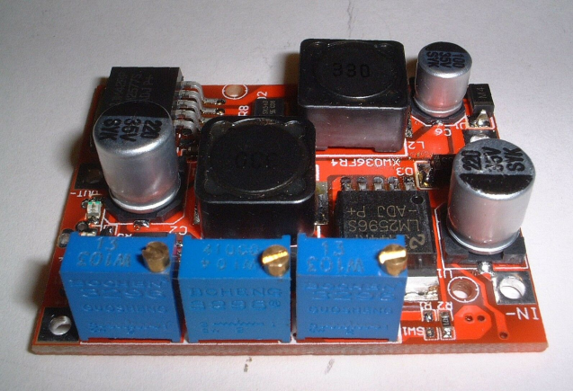

You can buy ready made modules that do exactly what you want, quite cheaply - eg. input 5 to 32V in, with a variable output that can be set to 15V:
Or 5 to 15V in:

yes, I thought about them too, but actually I am looking for a circuit that detects the input voltage and can work in buck or boost modes to keep the output stable.
maybe some unnecessary effort but I don't want the user to interfere with the circuit.
You mean exactly like that module?.
If you don't want the pots, replace them with fixed resistors.
Yeah. I want an automatic buck / boost converter. output voltage is constant 15V. but I don't want the pot just like you said. As soon as the user energizes the circuit, the dc / dc converter circuit should detect and give a constant 15V output. Can I do this with fixed resistors? How is this possible? For example, the user can apply an input voltage between 5V and 24V, it is completely up to the user. The user will not tell me the voltage value to be connected to the circuit. Only the circuit that will apply energy with sufficient power and the circuit will stabilize the output according to this voltage.
You simply adjust the pots for the voltage and current you want, then remove the pots and replace with fixed value resistors of the same values.
This is exactly what you would do if you built the circuit from scratch yourself - or calculate the resistor values instead, then tweak the values if need be.
If you download the schematic for the module (it will be available somewhere), you could copy it and build your own - but it would be considerably more expensive.
We put glue on the pots so they can not be adjucted.
The schematic is not published. But you might find it in the data sheets.

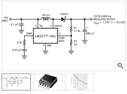

One of the links above does not use a "boost/buck IC" but uses a boost power supply much like this: (R1+R2=pot)

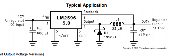

Then follows it with a buck supply like this: (add pot to pin 4 and use the LM2596-adj)
I do not think it boosts well. (certainly not to 3A)

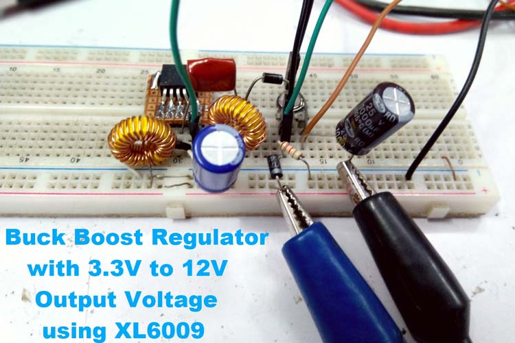

While the makers don't publish it, you can often find it on-line where someone has reverse engineered it.
Here's an example of a design similar to the XL6009 ones:
