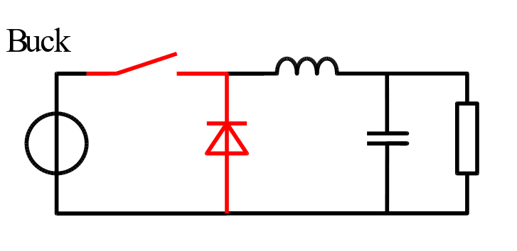

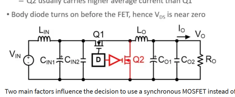

MacIntoshCZ Active Member Mar 15, 2021 #1 How mosfet can be turned on in this simplified version which use schotky diode? Only with gate driver transformer? With this synchronous version it could use bootstrap capacitor for Q1: https://upload.wikimedia.org/wikipedia/commons/c/ca/Commutation_cell_in_converters.svg **broken link removed** Last edited: Mar 15, 2021

rjenkinsgb Well-Known Member Most Helpful Member Mar 15, 2021 #2 Either a P channel FET with the gate being switched towards negative, or an N channel with a bootstrapped driver.

MacIntoshCZ Active Member Mar 15, 2021 #3 rjenkinsgb said: Either a P channel FET with the gate being switched towards negative, or an N channel with a bootstrapped driver. Click to expand... Yes i know about P channel, i just dont like to use them. They are more expensive and its harder to choose one.

ChrisP58 Well-Known Member Most Helpful Member Mar 15, 2021 #4 Then use a bootstrap driver. That's how most integrated converters drive their n-channel mosfets.
MacIntoshCZ Active Member Mar 15, 2021 #5 Ok thanks, i will probably use complete IC for synchronous buck converter. Since i know how its done i want use as low parts as possible =).
