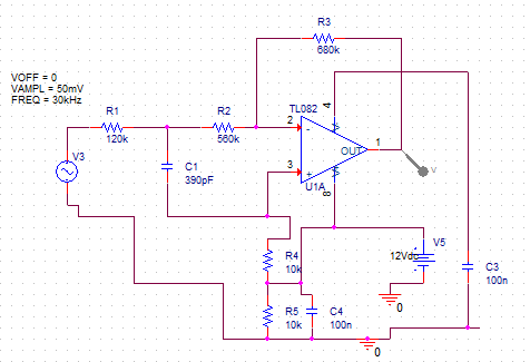

I have a small problem while designing my single supply speaker amplifier. It totally works in +12V and -12V but when I exclude -12V from the design and connect the + pin of OPAmp to Vcc/2, the output is only a DC value of 12V rather than 50mV as the input.(it is only a buffer) I cannot find a solution, i wonder someone can help me. Thank you all.

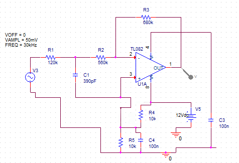

ok, here is the circuit: 12V to R4 (pin1) , R4 -R5 junction to OPA input and R5 to ground. I still get 10.5V DC (no AC signal) from the output?

Now you have the opamp biased correctly.
But the signal generator is shorting the DC voltage at R1 to ground because an input coupling capacitor is missing. Then the output goes as high as it can.
An output coupling capacitor is also probably missing.
It is not a speaker power amplifier.
Ok, I will try to add the input coupling capacitor. It is just a part of the speaker amp, buffer part. After the output, circuit has a output C and R connected to TDA7052. Thanks for the tip.
A TDA7052 amplifier IC does not need an input buffer because its input resistance is already high at 100k ohms. The input resistance of a TDA7052A (with built-in DC volume control) is 20k ohms.
ok, when i add a input coupling cap. the output becomes 50mV-p but at 6V dc. Should I always use another capacitor to eliminate DC offset?
One more thing, if I set this circuit by split supply, there is no need for this input capacitor!?
You want the output to have max voltage swing so you set the (+) input at half the supply voltage with 2 resistors. The feedback will force the DC voltage of the opamp output so that the (-) input is the same voltage as the (+) input. the input coupling capacitor prevented the 0VDC from the signal generator from making R1 at 0V so the feedback caused the (-) input and the opamp output to be at +6V.
This opamp might also need an output coupling capacitor to block its +6VDC.
Without an input coupling capacitor in this inverting opamp circuit then the (+) input will be at 0VDC and the opamp will amplify its DC input offset voltage.
