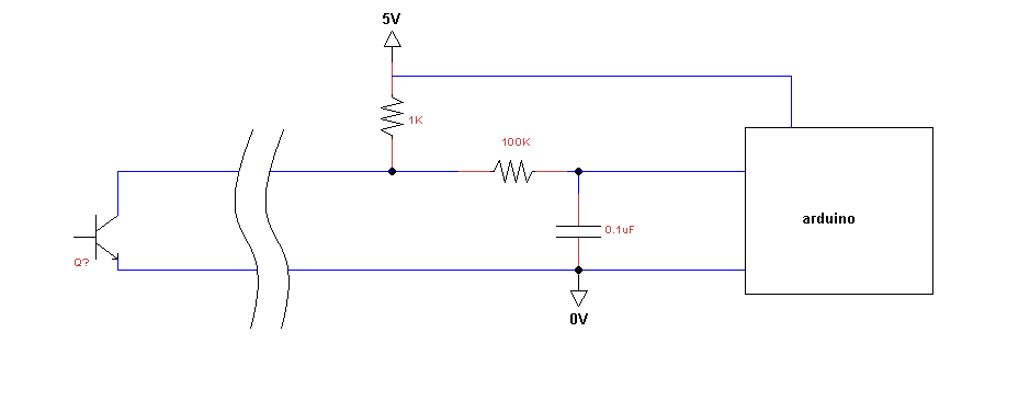

I have a project where I have a bunch of motion sensors that will be distributed over a distance of 40m. I want to connect them all back to an arduino but I need to know how long a 5V logic signal can travel unbuffered? (the motion sensors are open collector and will simply pull a logic line low when triggered)

Since you have ~250msec to detect the signal, I would run the signal line back to the uP along with the power and ground (three conductor cable). Shielding would be a plus, but not absolutely required. Put the pull-up resistor at the uP end, not the sensor end. Add some software filtering in the uP code that detects a level change that lasts more than some minimum time, like 250msec.

I can tweak the debouncing time to make sure it is reading a proper signal and there will of course be pullups near the uP pins.
The only way common mode will be a problem is if the sensors develop a voltage across the ground line. This is easy to figure out.

Agreed. Adding a simple low pass filter to each input would eliminate problems with RF in all but the most extreme cases:
longleads-png.32758
