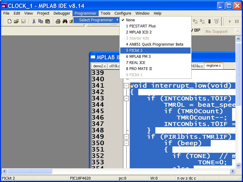

also when trying to write it to the PIC im having problems with MPLAB picking the programmer up its a PICkit 2 and im using the latest version of MPLAB and am running Windows Vista any advice ?

Are you saying that MPLAB can not find the PICkit2 ?
What is the actual output window text ?
Does it happen all the time or just now and again ?
You can always try rolling back MPLAB.
I am also using USB don't know if that matters or not and no this a new computer it worked fine on my old one so I don't know whats wrong
Connecting to MPLAB ICD 2
ICD0019: Communications: Failed to open port: (Windows::GetLastError() = 0x2, 'The system cannot find the file specified.
ICD0021: Unable to connect with MPLAB ICD 2
MPLAB ICD 2 Ready
MPLAB ICD 2 Ready
Try changing the programmer from ICD2 to PICkit2 :)
there's no PICkit 2 at all all just try installing MPLAB from the disk that came with it its a old one though so thats why I didn't want to do it that way

projects created with older mplab version but opened in the latest mplab version dont show pickit2 at my end also.
So try creating the project afresh and it should work fine.
