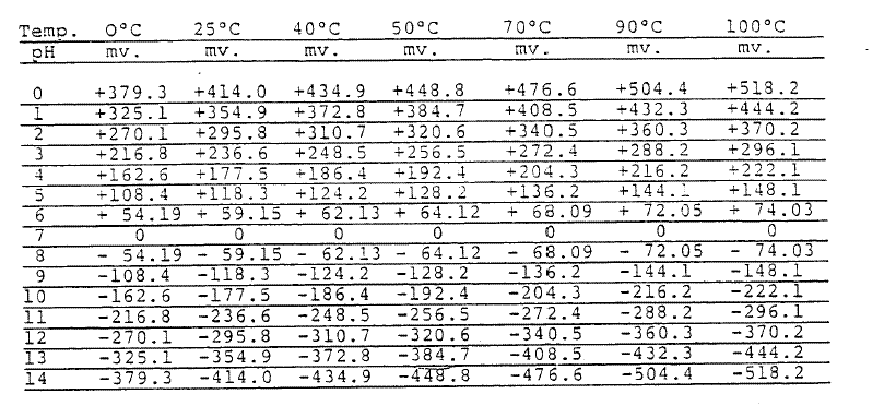

Here is a chart that may help

Thanks fried that will help a ton, any clue if theres a relationship between whats on the chart at each given degree that forms a slope/curve?
