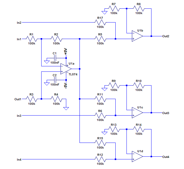

I have a controller that can scale a single DCV input/output, but I need need to build a box that can scale 3 additional DCV inputs/outputs with independent signals, all the same amount in relation to the output of the single controller channel.
The voltages are not constant, they swing from .1 to 1V rather randomly.

Input/Output signal will range from .1vDC-1.0vDC, with a voltage clamp @ .1v and 1.0v.
-Can I use the Vout of a differential amplifier between In#1 and Out#1 as the V1in on a summing amplifier for Inputs#2-#4 and then invert the outputs?

I'm just learning about OP Amps, I threw together a basic schematic, thought I'm lost as how to figure the correct resistances. I'm looking for a gain of "0", are resistors necessary?
Is there a simpler way to accomplish this?

Ok, I'll break it down for you.
You've got an Oxygen sensor (Input #1) , it creates a voltage through a chemical reaction, this voltage varies between .1V and 1.0V depending on the oxygen content of a gas stream (stream #1).
I've got a "piggyback" that modifies the voltage from this sensor depending on several variables. (Controller scale), and outputs it (Output #1)
This is all fine and dandy, everything works great.
Now, here's the problem:
I also have 3 more oxygen sensors (Input #2, Input #3, Input #4) that are each in their own separate gas stream.
Hence the voltages from all inputs are almost never the same. 4 sensors, 4 locations, 4 different voltages. But they all follow the same "range" of .1V to 1.0V
I need to build a circuit that can take Input #1 and subtract it from Output #1 (using a differential OP Amp?) to get the voltage "difference" .
Follow me?
Now I need to take this "difference" and add it to each of the other sensor values.
Make sense now?
If Input1= .2V and Output1=.2V then the difference is 0, all signals stay the same.
If Input1=.2V and Output1=.5V then the difference is .3V, all signals need to have .3V added to them.
If Input1 = .2V and Output1=.1V then the difference is -.1V, all signals need to have -.1V added to them (in effect they all need to drop in voltage by .1V).
Easier to understand?
John

Input1, Input2, Input3, Input4, and Output1 are predetermined, I only list I#1 and O#1 because it is necessary to know the difference between I#1 and O#1 in order to "process" the other signals.
EDIT: Disregard the schematic in post #1, as the input numbers don't correspond with the text of my post.
That makes more sense. The circuit below should work for you.

Once concern though, won't there be issues of "crosstalk" between the lines?
Thanks :) I'll give it a shot next weekend...
Not unless the output impedance of your sources (inputs) is very high. I made all the resistors 100k to hopefully avoid that potential problem.
The output impedance of the sensors is ~22Mohm. Should I build voltage followers/buffers into the inputs?

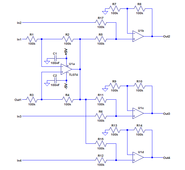

Do you have a datasheet that we can look at? I am concerned about their ability to provide a current path for the op amp inputs, even with voltage followers.

Where did you get the 22Meg number?
From a webarchive from a mailing list (that I just realized is about a decade and a half old...)
EDIT: the resistance is only >1Mohm until the sensor heats up, then is runs ~10Kohm.
You should buffer all your sensors with voltage followers. If Output1 impedance is not low (<1k or so) compared to 100k, you should buffer it too.
I don't know how to edit an attachment after the 60 min grace period has expired. I made an error on the previous schematic. Here is the corrected one (still without input buffers).
