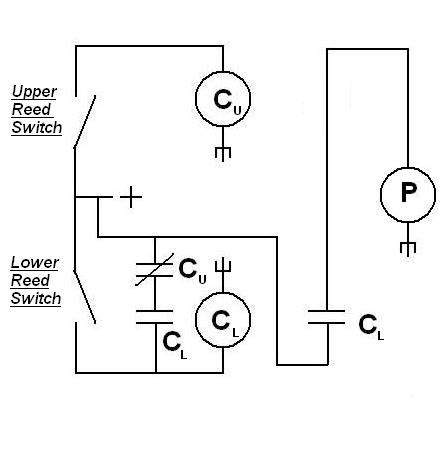

here's what I did on my buggy, one reed turns it on, the other reed turns it off. I use it to fill an auxiliary tank. The + is 12 vdc
