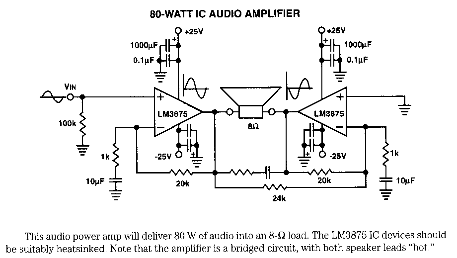

Thanx a lot for your reply, mechie.
I am now building this power amp I will give you some news when it will be done
