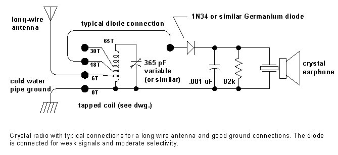

I'm trying to build a simple AM receiver (FM is too complicated for me at this point) with no success so far. I've tried messing around with pretty much simple circuits,
Yet I still get no sound from the speaker.
I'm wondering what values do I need for the variable capacitor / inductor.
On another side, is it possible to use some other type of oscillator for the tuning circuit? RC or crystal maybe?
Any help would be greatly appreciated.
You have a very simple "crystal radio" with the diode as the crystal. Look it up on Google for capacitor and inductor values.
The antenna must be very long, the ground must connect to a cold water pipe earth, the stations must be strong and local and the earphones must be high impedance. It doesn't have a power amplifier so it can't drive a speaker.
It is much too simple to have an oscillator. It is just a single tuned circuit (real radios have many) and an AM detector diode.
Oh yeah, use a fast diode, not a 1N400x rectifier that is too slow.

OK try this one........

People made simple crystal radios 70 years ago when there were hardly any stations so interference between them wasn't a problem. My city today has about 20 AM stations and there are many more all around, so I think a simple crystal radio will pickup most of them at the same time.
A super-heterodyne radio has many tuned circuits for good selectivity. It also has amplification for good sensitivity and doesn't need a long antenna and earth connection. It also has a power amplifier to drive its speaker.

Thank you alot rigdoctor99. I'm just wondering why many circuits require low impedence headphones .. Couldn't some AF amp help out?
I try my best at not being a newb. But sometimes you just have to. :D
I think you mean HIGH impedance headphones?, it's simply because it avoids the need for an audio amplifier - historically 2000 ohm headphones were quite common, and you can use piezo ear pieces as well.
