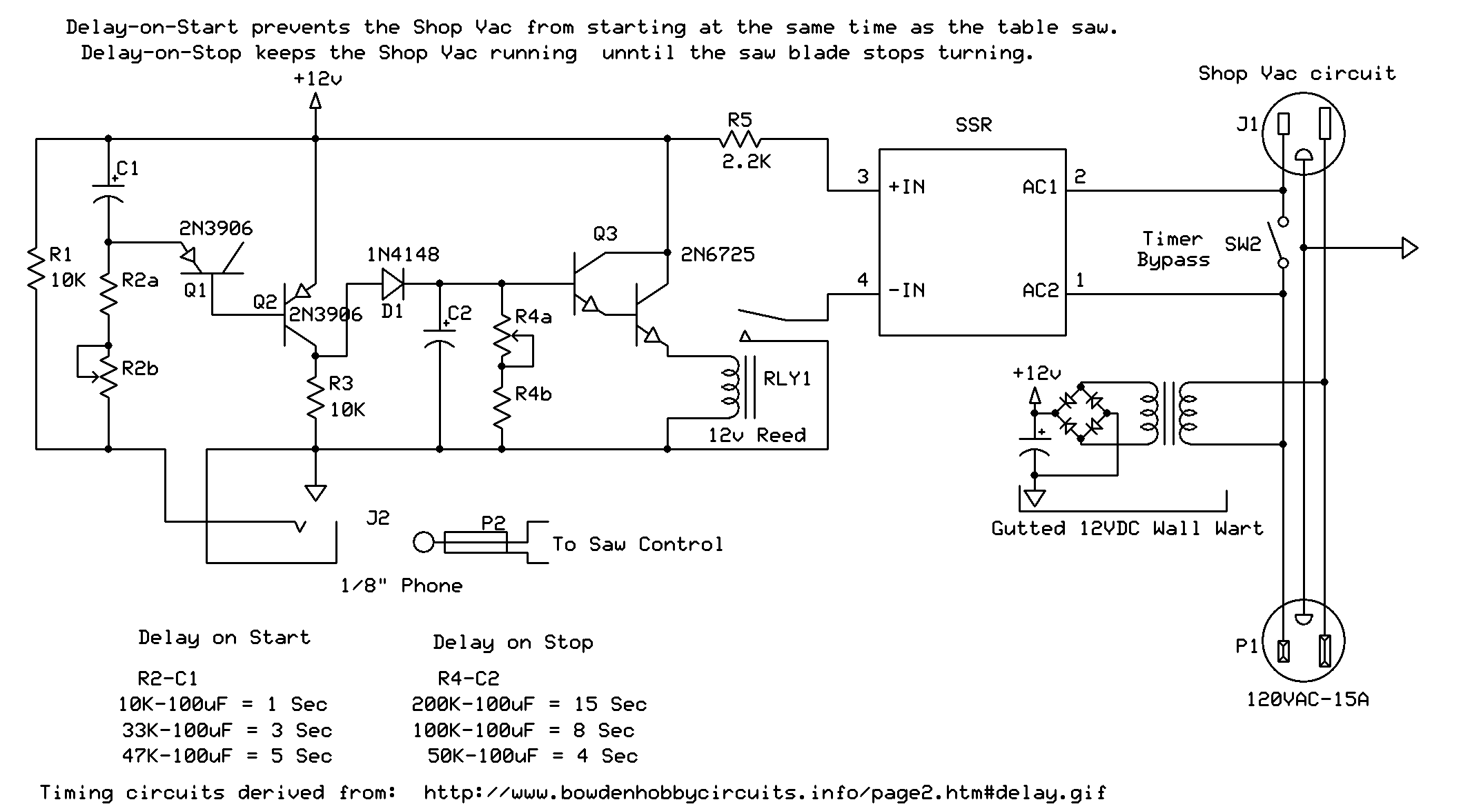

Huey,
Mine is on a table saw at work and I'm off today, but can take a picture tomorrow. You may or may not have noticed that some things are left off the schematics. When I posted those, it was just to get the concept and basic circuit out there. I'll see if I can put together a more complete schematic.
Ken
Sorry about the mixed order.

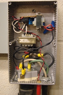

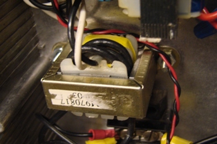

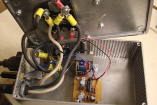

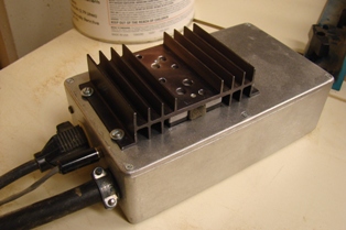

1st photo: Current transformer in saw start control.
2nd photo: Inside saw-start control box.
3rd photo: Shopvac delay schematic.
4th photo: Inside Shopvac delay box
5th photo: Saw-start control schematic.
6th photo: Shopvac delay box.
7th photo: Saw-start control box.
Ken
