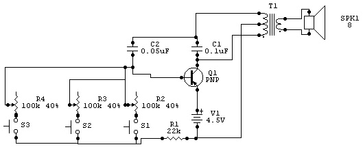

Ok, here you go. This is the type commonly used in toy organs. The nice thing about this is that you can get away without needing the AD envelope, and it can directly drive a speaker with some volume (good enough for use in a quiet place at least). I have not tried this as I have drawn it here, so I advise testing this on a breadboard first. Each of thos 100k pots will set the picth for that corresponding key switch. The overall frequency is determined by the 0.05uf cap, and the "tone" can be altered by changing the 0.1uf cap (although this does affect the frequency too, a larger cap makes it more bassy). The transformer is an output type, 1k to 8ohm CT or similar. The transistor is a PNP, try any you have in this, the one specified is rare.
In the original, the circuit is switched on the positive rail, this is witched on the negative, as that is where the resistors are. I only assume this makes no significant difference.

Thanks Dr. EM for your circuit. I'm glad that I can follow the circuit, but if I use a NPN transistor I can just flip the battery, can't I?
I will try to do breadboarding and will post the result but it will take time ;)
Yes, you could use NPN and flip the battery, I would also add an electrolytic across the battery as well!.
