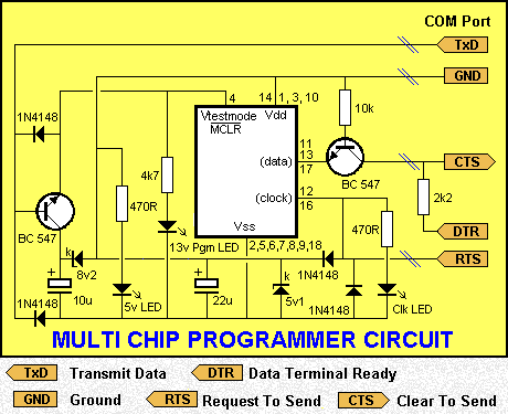

Here is a circuit diagram which can program some PICs up to 18 pins.I built this and still I'm using it.A nice LVP programmer circuit.I've tried PICs like 84,84A,628A & it works fine..
here is the original link

Ok I just finished putting it together on a proto board.
I built the following: JDM Programmer (Ludipipo)
I have hooked it up straight to my com1 port on the computer. Now how the heck do I check to see if it is working? :confused: :D

I loaded a hex file using ic-prog and then attempted to copy it to the pic. Nothing seems to happen.:confused: Is there anyway to do a check just to make sure the comp and software is seeing the pic? Also while using ic-prog it seems that everytime i load it or execute a command i get the message "priviliged command" is that normal?
From where did you get the hex file? Did you intalled the driver of IC PROG? if installed check the hardware tab in the IC PROG whether is correctly fixed to COM PORT..Also check whether windowsNT chechbox clicked.restart IC PROG & feed the hex file.

The windows nt was not checked and I missed the driver part. That seems to have fixed my prob. Thanks for the input. Wow it only took 6hrs to build this and get it running :eek: lol. Well now I need to put it to use. :D Any suggestions?
