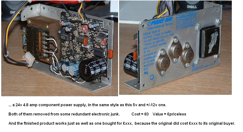

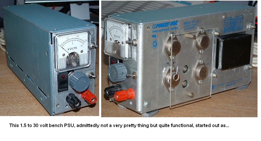

However, if you have some old equipment (junk?) which partly does what you want, modify it
so that it will do exactly what you want. Now compare costs, you will have made a good saving.
I suppose it's just nice to be able to say " i built this "?
Yes it is, especially when you have made something useful out of a pile of junk.
As time goes by and you have been at the hobby for a number of years, you build up a supply of "stuff", especially if you are professionally associated with electronics as I am, (or should say was).
From that supply of stuff, if you have room to store it, over the years varous things which in themselves are just junk, can come together to make something useful.
Have a look at the attachments for an example.
