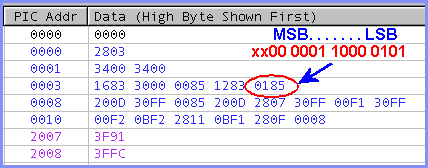

Ok, now this leads to my next question. Here's the hex file for the simple LED blinker:
:020000040000FA
:020000000328D3
:040002000034003492
:0A0006008316003085008312850187
:100010000D20FF3085000D200728FF30F100FF3054
:0C002000F200F20B1128F10B0F28080071
:02400E00913FE0
:02401000FC3F73
:00000001FF
The last 16 bits of the 4th line are 8501. In binary, this is:
1000 0101 0000 0001
I picked this one out because at a quick glance I see that the first bit and the 16th bit are both 1's. How do I make this a 14 bit word? It seems like I need all 16 bits of it. I think there is something fundamental I'm missing here.
According to the programming spec, you keep data line low and clock the PIC. This is the leading bit.
Then you send the LSB, the next higher bit...MSB of the program data. This sequence total takes 14-bits.
Afterwards, you keep data line low and clock the PIC. So all together you have sent sixteen bits, with the 14-data centered inside the 16 bit.

Ah, I wasn't swapping the lsb's and msb's visually in the hex file. L.Chung, thanks for including that graphic of my hex file. It makes it much easier to see the data that way. So my understanding is, then, that the hex file is created with pre-padded values. How convenient.
The data is right-justified with LSB at position bit0 of the 16-bit word. The 15th and 14th bit of the 16-bit word is padded zero by the MPLAB assembler.
