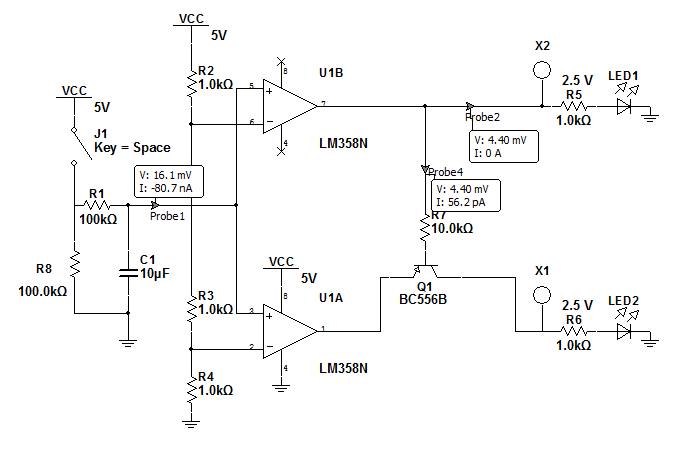

Here what I need: a button that as soon as it's pressed sets HIGH something, then after 3 seconds turns that LOW and turns HIGH a second line. As soon as it is released, both must go low.
exact timing is not important, and I'd like to do it with few components..
I tried with 2 opamp and a transistor, plus a lowpass filter for timing... it works partly but when you release the button it doesn't go LOW immediately (since the capacitor discharges slowly..) besides I know there must be a much more elegant and easier way!
thanks!
Have you thought of making the pushbutton supply the Vcc to the rest of the circuit? That would kill everything when you let off. Then there's the idea of a DPDT switch using one set of contacts to dump the cap at release time.

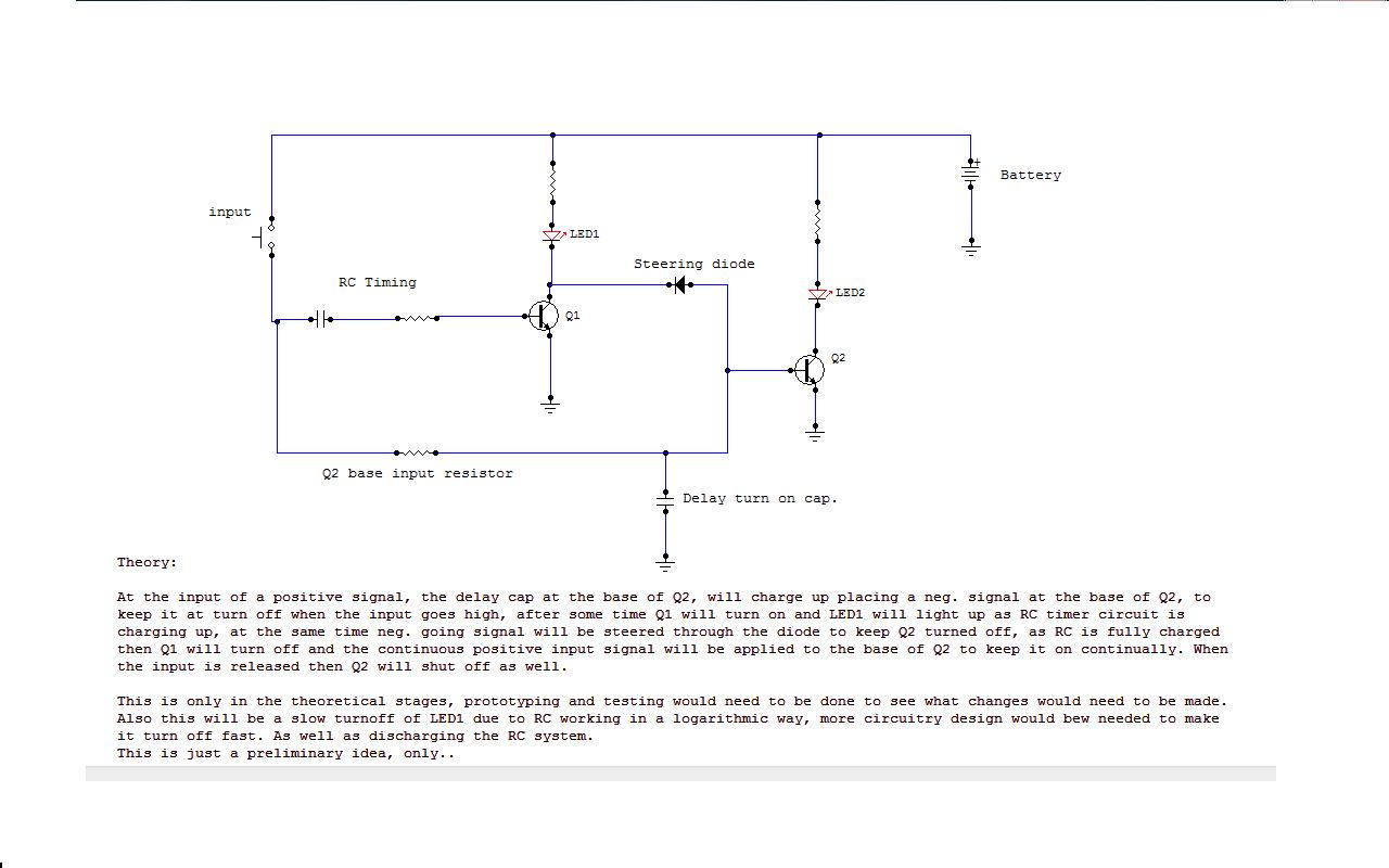

Theory:
At the input of a positive signal, the delay cap at the base of Q2, will charge up placing a neg. signal at the base of Q2, to keep it at turn off when the input goes high, after some time Q1 will turn on and LED1 will light up as RC timer circuit is charging up, at the same time neg. going signal will be steered through the diode to keep Q2 turned off, as RC is fully charged then Q1 will turn off and the continuous positive input signal will be applied to the base of Q2 to keep it on continually. When the input is released then Q2 will shut off as well.
This is only in the theoretical stages, prototyping and testing would need to be done to see what changes would need to be made.
For instance the RC timer should be seperate from the bias of Q1, so Q1 has its proper bias and the RC timer interacts with it.
At the moment the base bias for Q1 is determined by the RC itself, not a good idea.
Also this will be a slow turnoff of LED1 due to RC working in a logarithmic way, more circuitry design would bew needed to make it turn off fast. As well as discharging the RC system.
This is just a preliminary idea, only..
timer

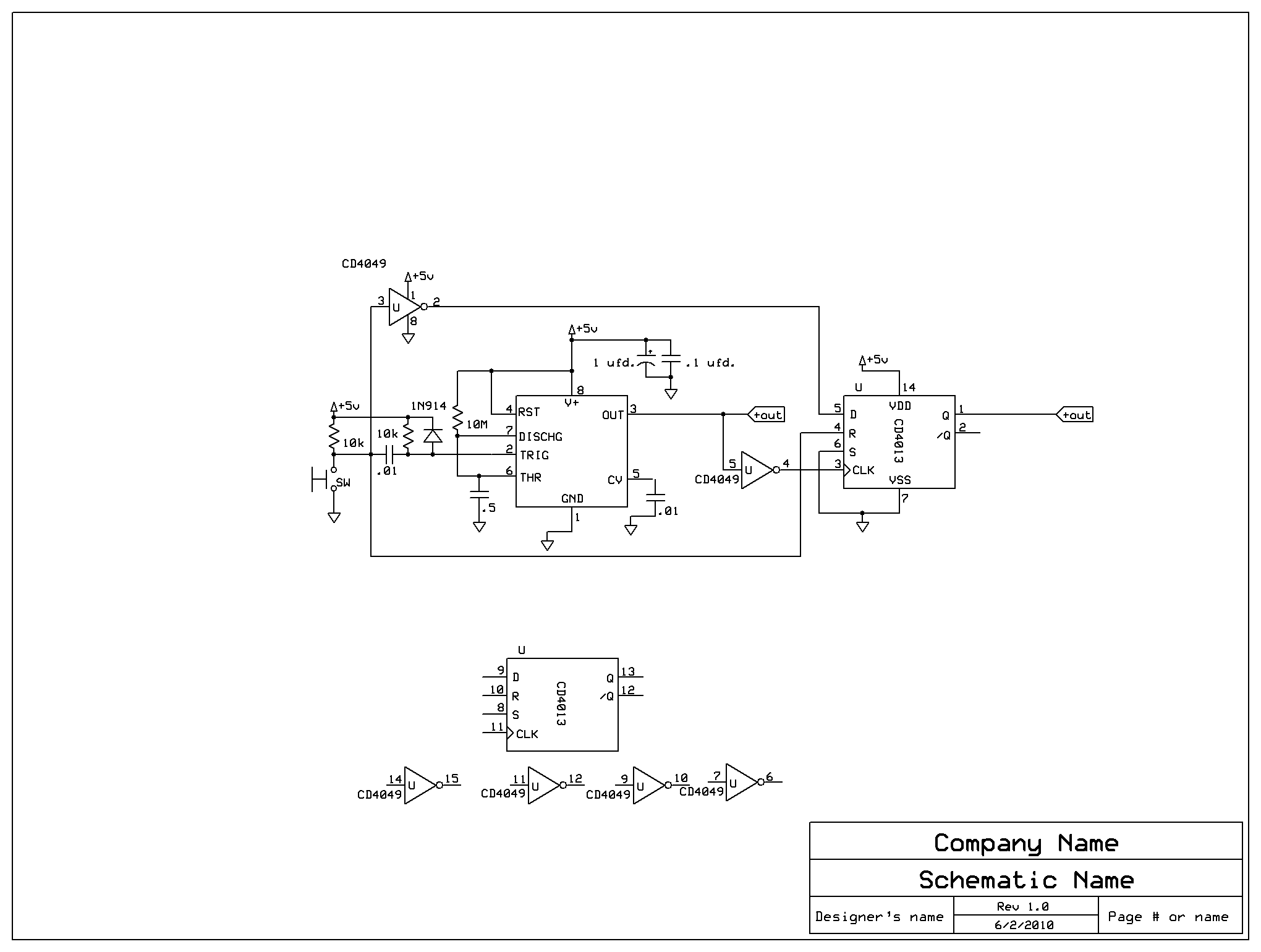

Here is one that might work. After re-reading your post however there is one problem. The 3 second timer will not reset when the push button is released. It will continue to time out for 3 seconds. Does that matter? Let me know if it does and I'll have another look.

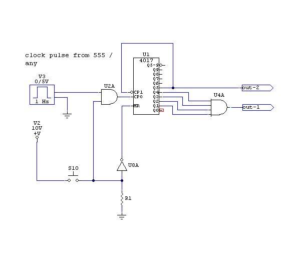

see the attached circuit using 4017 counter, when the push button is not pressed the counter remains on reset, when the switch is pressed it will give high to out-1 immediately within a second. then continue to hold the pus button pressed will make out-2 high after 4sec. hope this may be the one you need.
