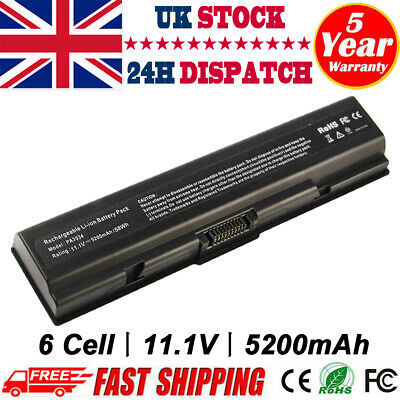

The battery is presumably one of these, then:-
If so it's a six cell, two parallel sets of three cells.
(Ignore the supposed voltage difference; different makers rate each cell at different voltages - 3.6V, 3,7V and sometimes 4V - all of which are within the voltage range for 0 - 100% charge of a lithium cell.)
Edit - someone doing a cell replacement on one of those exact batteries!
