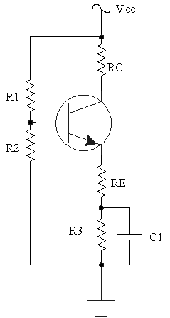

Its a Bypass Capacitor in parallel with the Emitter Resistor if the AC voltage or current goes in at the Base of the transitor the AC goes through the Bypass Capacitor (not a Coupling capacitor) instead of the emitter resistor to increase the Gain but how does it increase the gain ?
In the attached CE, NPN transistor amplifier, biased as Class A. If the capactive reactance of C1 is 1/10 the value of R3 at the lowest frequency to be amplified, it will not affect the gain, as the gain is set by RC/RE. R1,R2 and RE+R3 set the bias point, and the no signal collector current.

So how does C1 the bypass capacitor adjusts the Gain?
is it passing AC frequencys? AC voltage? AC current?
or is is passing DC?
What does C1 really do ?
It looks like to me that AC freqencys,voltage,current goes through the
C1 and goes straight to ground but how does that increase the gain?
Can someones please tell me or give me a signal Analysis on this?

As stated by me earlier that the gain of the CE class A amplifier is = to RC/RE. If RC=10k and RE=1K the gain would be 10.
If one remembers that capacitive reactance decreases as the frequency increases and reactance is also known as AC resistance. This AC resistance is C1 which is in parallel with R3. So the gain at AC = RC/((RE+(R3//Xc1)).
Lets take a for instance: If R3 is 470 ohms and at some frequency C1 is
47 ohms, we now have 47 ohms in parallel with 470 or AC resitance of 42.7 ohms. At this frequency the actual gain = 10K/(1k +42.7ohms) or 9.59. Going one step further if at some frequency the Xc = 470 ohms, then the AC gain =10k/(1k+235ohms) or 8.1.
From this one can see that the AC gain of the stage will decrease depending upon the reactance of C1.
If RE is replaced with a short circuit and the values of R1 and R2 are recalculated for idle current, then the reactance of C1 will increase the AC gain of the stage.

But we can't short the emitter to ground directly because that will not Bias the transistor the emitter resistor keep the transistor in bias operations i think.
The bypass Capacitor is a "Frequency based" gain circuit
