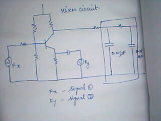

should the value of the bypass capacitor be larger, if so how large.
can a ceramic capacitor with 0.01 µF act as a bypass capacitor.

take a look at the following mixer circuit in the attachment
my teacher says that the last part [the part that i have boxed] is a filter.
but when i did my practicals i did not get any output in the CRO if those capacitors were present.
the output that i must get is the difference of the two frequencies Fx and Fy.
can it be explained.

The amplitude at the output will depend on the frequency of the circuit and the value of the resistors.
Correct, it is a low-pass filter.
The output of the mixer will contain the frequencies:
Fx, Fy, Fx+Fy, Fx-Fy, and probably many others such as 2Fx-Fy, 2Fy-Fx etc.
The task of the filter is to remove everything except Fx-Fy which will be the lowest frequency in the output of the mixer, hence the use of a low-pass filter.
What you need to consider is, what frequencies were you using in your practicals?
What is the cutoff frequency of the low-pass filter?
