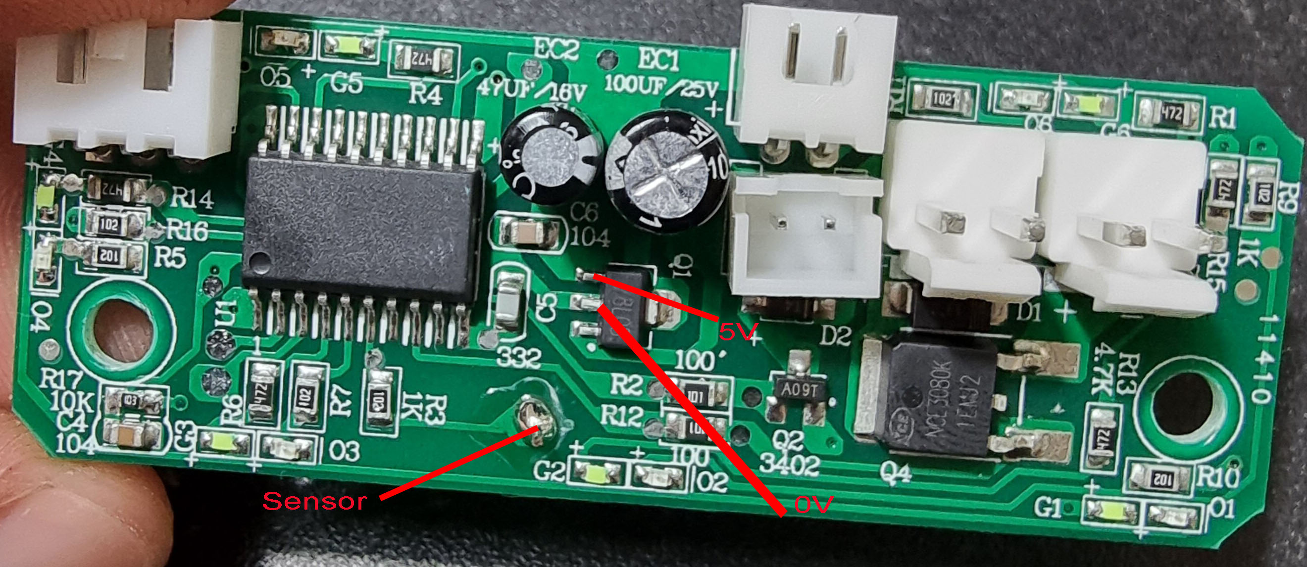

Hello, sorry for my bad English but I need some help on this...
So I have a controller board from a humidifier and I want to make him smart, so I'm adding a "smart switch"
( https://a.aliexpress.com/_EyQEmC5)
This can send a pulse for 0.5s, just like the Touch of a finger, but I can't figure on the board were i should sold the 2 wires that will make the "pass"
I let u guys some pics of the board, if u can help me
Does the humidifier have a touch switch, or a momentary pushbutton, for power?
If so, which connector on the PCB does it connect to?
Try touching a wire short bit of wire from either the 0V (centre of 78L05) or 5V (top pin of 78L05) to the sensor terminal?
One or the other will hopefully be seen as a touch trigger.
Use a bit of thin insulated wire so holding it does not trigger the sensor.
I've tried and it works perfectly, the sensor with the OV trigger the PCB on, tnks so much for the help, I was just wondering if e could get a "power supply" of 5V to power the smart switch, because it works at 5v and this board I can only read 12v on it

The top pin of the 78L05 should be 5V, however it will not be able to provide much current, possibly 100mA maximum.
You could try it; if the 78L05 gets uncomfortably hot, it's too much for it.

So let me just see if I understand, I try the positive 5v from the top pin of 78L05 and for the negative should I use the 12v line?

Touch sensors work either by picking up "hum" or by body capacitance shorting a signal they put on the sensor.
Try connecting a small capacitor (e.g anything around 10nF - 0.1uF) between the circuit "ground" (negative power input) and a touch contact? If that works you could use a relay or possibly even a small MOSFET such as a 2N7000 series to ground the capacitor? The connecting wire for anything but ground need to be as short as possible.
If grounding it via a cap does not work, try connecting it via eg. a 1K resistor to ground or the sense IC positive supply pin - I can't make out the IC part numbers in the photo, but the centre 8 pin one appears to be the touch interface.
The number on that IC would be helpful?
It appears most 8 pin multichannel touch sensors use an I2C interface - with data on that IC, it may also be possible to emulate it with another MCU??
