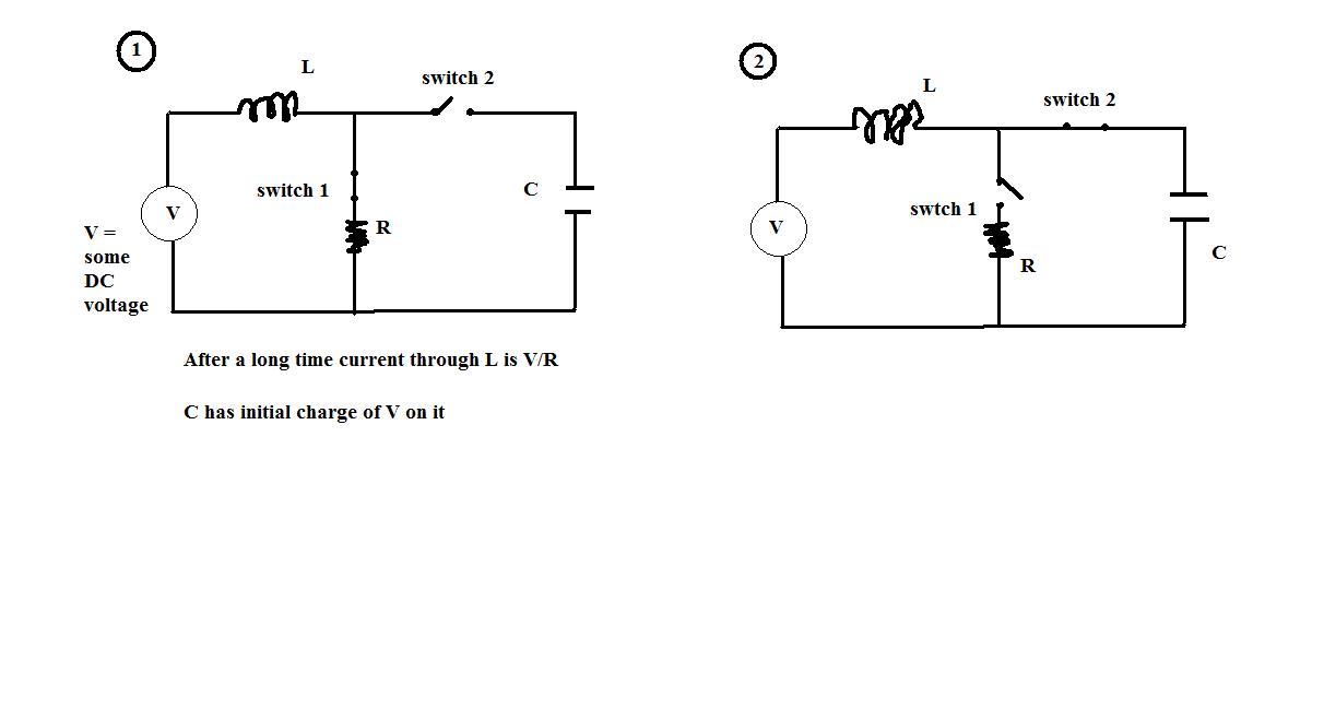

C charged by L above its rated V = ?
confounded
Suppose the initial circuit is as in 1 on my sketch.
After all transients have died away the current through inductor L is V/R
The capacitor has an intial voltage of V on it
Then the swicth 1 opens and 2 closes
The inductor will supply current V/R to the capacitor depositing a charge Q.
However what i would like to know is, if the capacitor is rated at voltage V, what will happen?
Will the capacitor explode?
Short answer:
Yes if there is enough energy. No if there is only enough energy to
short it out and discharge the inductor and the remaining current
isnt enough to blow it up (depends on actual supply voltage internal
resistance).
Sometimes a cap will arc over and then seem to work ok after that too.
What you have there if you make R very low is basically a boost converter.
The voltage to the cap gets boosted up to a voltage higher than the
supply voltage. If the voltage is too high, the cap either blows out or
explodes.
I've seen large electrolytic caps blow up like cannons.
