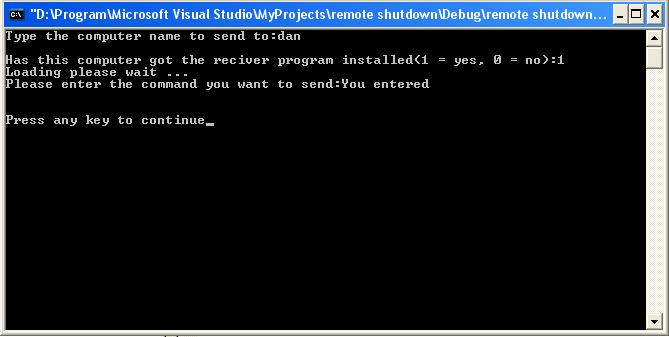

the code you posted didnt work i did a screenshot.
btw: it is not a DOS program just a console

#include <iostream>
#include <windows.h>
#include <string>
#include <fstream>
using namespace std;
int main(int argc, char *argv[])
	string who_to_send;
	string addon = "\\C\\TMP.TMP";
	string addbe = "\\\\";
	cout << "Type the computer name to send to:";
	cin >> who_to_send;
	addbe.append(who_to_send);
	string final = addbe.append(addon);
	cout << "\nHas this computer got the reciver program installed(1 = yes, 0 = no):";
	int yesno = 0;
	cin >> yesno;
	ofstream file;
	cout << "Loading please wait ...";
	file.open(final.data(), fstream::out);
	if(file.fail())
		cout << "\nLoading failed!";
		cout << "\nThis program will ternamate in:3";
		Sleep(1000);
		cout << "\b \b";
		cout << "2";
		Sleep(1000);
		cout << "\b \b";
		cout << "1";
		Sleep(1000);
		return 0;
	if(!yesno)
		fstream file2;
		cout << "\nCopying...";
		file2.open(argv[0], fstream::in);
		string copy1;
		copy1.append("copy ");
		copy1.append(argv[0]);
		copy1.append(" ");
		copy1.append(who_to_send);
		copy1.append("\\\\C\\remote_shutdown.exe");
		cout << copy1;
		system(copy1.data());
	cout << "\nPlease enter the command you want to send:";
	char com[30];
	cin.getline(com, 30);
	cout << "You entered " << com;
	file << com;
	file.close();
	cout << "\n\n\n";
	return 0;
Right, it seems there is still a EOL character in the stream that wasn't extracted from a previous input action..
try adding a "cin.get()" in front of the "getline()" command.
It's because of this:
int yesno = 0;
cin >> yesno;
You type a number (1 or 0) and then press the enter key, this puts the number + a EOL (enter) in the stream
The overloaded operator 'istream::eek:perator >>()' only reads your number from the stream and stores it in your variable yesno.
The EOL however stays in the stream - When you call the 'getline()' it will return immediately because the first character it reads is a EOL.
the extra istream::get() gets the EOL out of the stream.
