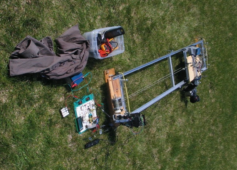

Here's my project - a motorized dolly for fancy time-lapse photography. Shiny on the outside, rubbish on the inside. And apparently 90 degrees rotated.

PS. Cool motorised dolly. :)
