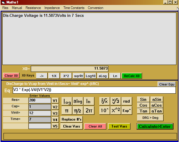

For those high value caps a 0.3Farad, a 12V starting voltage would decay to 10.5V in 7 seconds, into a 200R load resistance
A 1Farad down to 11.5V in 7secs.

Well I bought a 1 farad from maplin today for £40 and it works brilliantly. It has its own LED voltage level indicator and if its to be believed then the voltage when the valve finished closing was exactly 11.5V. Well predicted Eric!

hi 333,
This image shows the formula used to determine the voltage at a given discharge time.
E
