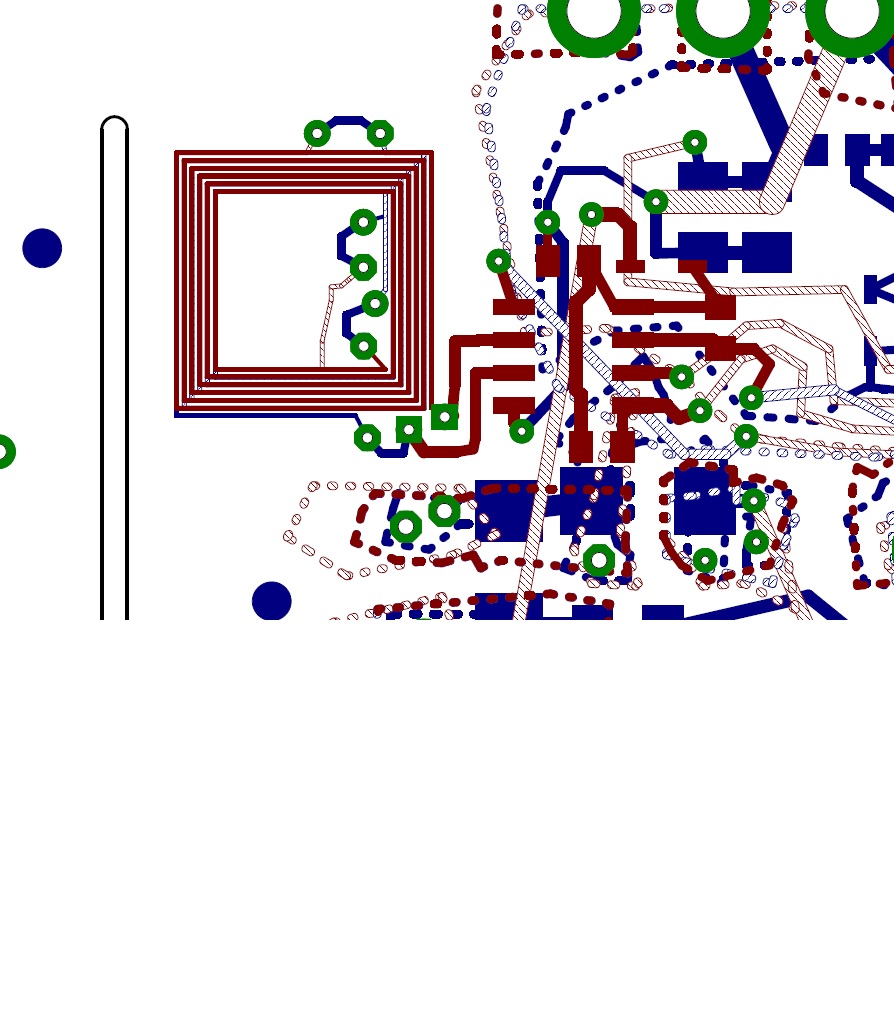

To summarise, we are trying to use the ST25DV04K-IER6S3 (13MHz Near field Radio receiver chip) to receive data to our PCB….this data is then retrieved by the microcontroller on this PCB.
The st.com software app which calculates the antenna for this chip, has made the antenna 2cm by 2cm , and we don’t have room for that on any of our PCBs. Therefore, we have decided to use a 1cm by 1cm antenna (as shown) and we are trying to compensate for the small size by having the antenna spiral down through the 4 layers of the PCB …thus giving us more turns, but without having the wide diameter.
Also, we have made make/break links between the coils of each PCB layer, so that we can experiment and see which number of turns receives the near field radio wave the best.
Do you think that our ploy is bogus?

Based on the PCB diagram, and the 1 cm outer dimension that you provided, I measured an inner dimension of 7 mm.
Turns per layer: 6
No. of layers: 4
Average space between layers: .5 mm (estimated based on typical 1.5 mm thick 4 layer board)
Trace width: .33 mm (estimated from diagram)
From the above parameters, my software gives an inductance value of 6.64µH.
I should also point out that the sensitivity of an antenna is proportional to its effective aperture, which is proportional to its physical size. Since you've gone down from 2x2 cm to 1x1 cm, you have 1/4 of the aperture of the recommended antenna, and therefore about 1/4 of the sensitivity.
Actually you could have 5 layers of coil. Stamp antenna but really just the old fashioned loop antenna. The feed throughs will kill it, use thru hole if needed. Commercial outfit used that technique for ferrite coils. Make it oval or rectangular to get size up. Trace size and spacing will determine Q.
