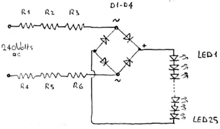

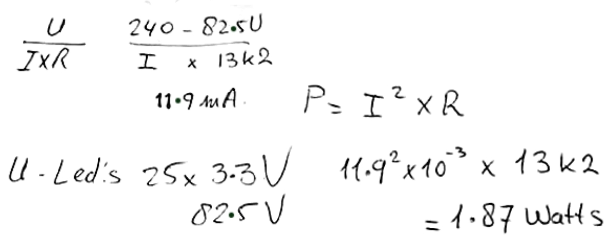

2)
Power of the circuit is calculated only once and the voltage drop of the Diod 1N2007 has not be taken into consideration. My inquisitive electronic mind was anxious that, Like the LED wizard, why was power dissipated not calculated two times (once in LED and other for Resistor) to get the total power.

The LED wizard calculates the power in the resistors so you can select a resistor power rating that does not fry them.
It calculates the power in the LEDs so when they are crowded together then you can provide enough venting to cool them.
Battery running time is determined by current but you can calculate the current if you know the power dissipated by the load.
