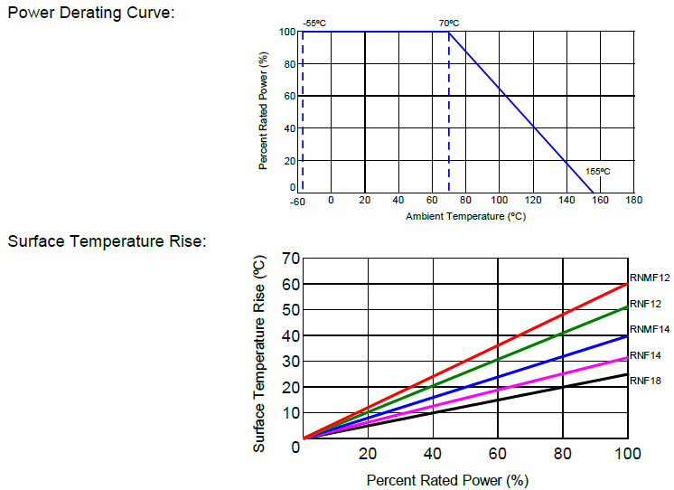

Look up the data sheet on your resistors. There should be curves like this.
I hit up google before I posted. Unfortunately I purchase from surplus suppliers so I don't know the exact manufacturer. I did a google search and found websites for Riedon, Vishay.Dale, Ohmite, and Caddock. None of them provided any information related to the second chart or thermal characterization (degC / W). From whom did you find the second chart?
first data sheet I looked for, see attached.
I think they should have (degC / W).
  • SEI-RNF_RNMF.pdf
One would think so, but I don't see it. That's the only datasheet that has that graph for metal or carbon film resistors. The datasheets for the "true" power resistors (sandstone, etc) have a whole bunch more other information.
Based on the reply from AnalogKid, I'm thinking the resistors that are 50%, especially those over 60%, need to be sized up.

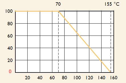

Digikey.com

From Yageo resistors:
At 155C the resistor has a 0 watts rating. So that is to say that this resistor should not get above 155C.
I think at 70C air temp and 100% power the body of the resistor is at 155C.
So (155-70=85) My guess is that 100% power causes a temp rise if 85C.
I really hope air temp isn't 70 degC. LOL.
I'm not so sure we can make the leap that 100% power causes the resistor to rise to 155 degC. Seems like a second leap of logic mixed in there.
I agree that at 155 degC the resistor cannot dissipate any heat. That's in the chart, indisputable. But it cannot be said that 100% power usage will drive the resistor to 155 degC. At 70 degC, you have 100% of the power rating. At 120degC the resistor is now only 40% of the specified wattage rating (turning a 1W resistor into a 0.40W resistor).
I don't see anything there that indicates what the temperature rise of the resistor will be based on the load (amount of wattage used). The key there is to get the package thermal characteristics (degC/watt).
That's correct.
But assuming a full power body temperature of 155°C at a 70°C ambient is what the graph is showing.
A linear derating from 70°C to 155°C, with the body temperature staying at 155°C will give a power rating of 40% of the value at 70°C for an ambient of 120°C.
Why do you think otherwise?

You are listing three variables on a 2-D graph. The graph is ambient temperature vs. rated power. There is no place for body temperature in the graph.
At 150C ambient and no power we know the body temp is 155.
At 70C ambient and no power we know the body temp is 70. (at 0W we know the body temp = ambient)
I made an assumption: At 70 ambient and full power, body = 155. I assume this based on the idea that '155 body is max' at any power level. Reading between the lines, I think 85C rise in temp is for 100% power. (42.5C for 1/2 power. 21C for 1/4 power, etc)

We can derive body temp by (ambient + (85C X (percent power)))
At 155C ambient and no power we know the body temp is 155.
I can agree with both of those statements. No power dissipated means amibient temp equals body temp.
At 155degC the resistor cannot dissipate any heat (has 0W rating, ie. useless)
This section I don't agree with. The graph states ambient temperature versus wattage. If the ambient is 70degC then the resistor is rated for 1W. It doesn't say body temperature versus wattage.
If I extrapolate your equation, then the resistor is NEVER usable at 1W. At 0degC and 100% power the body temperature would be 85degC and knocked down to 80% wattage. This would not be a very useful device, as there would be no way to use it at 100% power. In summary the body temperature cannot be inferred from the graph of ambient versus wattage rating.
My equation may be wrong, but the resistor can do full power at 70 air temp. There is a triangle bordered by 70@100, 155@0, and 155@100. This is typical of heating elements.
I see your logic. The equation you propose is correct (or matches your logic). 100%
But I think it is a leap to say that at 100% of the rated power the body temperature will rise 85degC. But with that said, that is the question. At a given ambient temperature for a rated power dissipation, what is the expected rise in body temperature. TO-220 transistors give this information under thermal characteristics in the line item degC/W. I think the same thermal characteristic is needed here. But I have been unable to find it.
