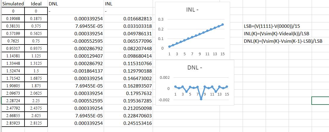

I have designed a 4-Bit DAC whose Output is as shown in the attached simulated.txt.
I need to calculate the INL and DNL of the DAC. It also has some gain error.
I tried calculating the dNL and INL. But I think something Fishy is going on with my calculations.
Please help me calculate INL and DNL of this DAC.
i consulted many books and i found some texts but could not verify my calculations.
the picture file contains the calculations done in excel. sorry this forum doesnot support excel file so, i have shown some calculations in the text file.
Please help. what am i doing wrong. how to calculate these parameters with gain and offset errors.

Are your tests consistent with the definitions in this app note?
Dear Mike,
I have gone through this app note already.The problem is that my DAC has some gain errors, I don't know how to nullify this error.
this note suggests that INL can be measured after the other errors are nullified
if you have some example workout, it would have been a lot help.
