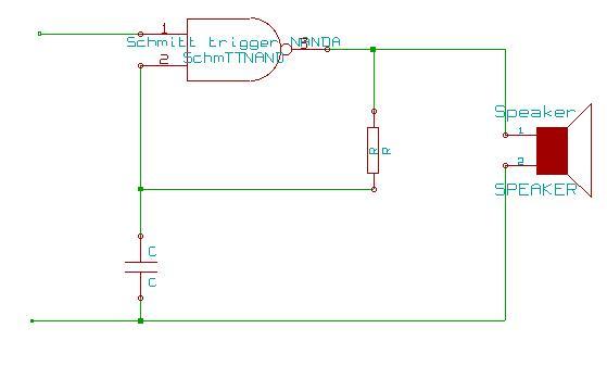

Hello Electronics People
I have a tiny problem that i hope some of you can help me solve...
Currently i am making an electronics project at school, where i, among other things, have to make a speaker circuit
that makes a sound at 500Hz and a few other frequencies...
I would like to know how to calculate which resistor i should use, to make the right frequency..
Ive added a picture of my diagram.
The schmitt trigger nand gate is a CD4093BE, the speaker is a sonitron - SMAT-21, and the capacitor is a 220uF.
Ive tried using a few different formulas, but i cant seem to hit the frequency that i want. I dont know if this has got anything to do with the delay of the nand gate, or the fact that i havent taken some data into my calculations.
For some reason i cant upload images to this forum so i have a link here instead.
Hope you can help me.

You are shorting the output of the Nand gate with the d.c. resistance of the speaker. Put a 100uF DC blocking capacitor (+ to gate) in series with the speaker. Also, the speaker impedance should be high, like 500 Ohms. If it is a low impedance speaker (4-35Ohms) that is too low for the Nand gate to drive.

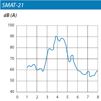

The "speaker" in this case isn't quite a speaker as many of us think of a speaker but rather Piezo Element and the data sheet can be found here. I don't know that the best choice is the SMAT-21 since you mention 500 Hz. but I guess it will work.
I suggest you read this for some information explaining how your CD4093BE NAND Gate actually works as an oscillator. Focus on the "Oscillators" section of the link. You want 500 Hz, your capacitor is 220 uF but you fail to mention the important Vdd? Again, read the link and see where Vdd figures into things.

The piezo transducer is shown being driven push-pull by two CD4093 gates and other Cmos gates and inverters in its datasheet.
Its frequency response shows a peak at 4kHz and not much response below 3kHz or above 5khz. It is a whistle.

I can't help but wonder looking at the original post if the frequency shouldn't be 5 KHz and not 500 Hz? My thopughts when I first saw the "speaker" was a pizeo I thought that 500 Hz. seemed peculiar. Oh well, I guess we await the return of the OP to see what exactly they have in mind because I sure don't quite get it. :confused:

Vdd is 5V.
ive found out that the schmitt trigger triggers at 3.2V.
when i put in a 48k resistor i get a freq about 250Hz

I have tried to use this formula to find the right resistor... But i seem to get a negative resistance value, which means that i am doing something wrong.
Use the formula MrAl provided in his post. He even provided a few examples to work from.
Ron
When i use his example with my current values like a capacitor of 220nF and a resistor of 9k i get a frequence of 1.6mHz which is not correct...
When i make this setup i get a frequency of around 1kHz
