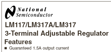

The LM317 isn't a transistor, it's an Intergrated Circuit voltage regulator.
The R27 resistor is probably a fusible resistor.
What sort of current are you planning to draw?
You'll only be able to get 1A with the LM317 on its own, but with other componants 3A is easilly possible (see datasheet).
Which circuit are you planning to build?
Hero999 said:
You'll only be able to get 1A with the LM317 on its own, but with other components 3A is easilly possible (see datasheet).
Yeah, look at its datasheet. It givs a lot more than only 1A.
You must be thinking of the 78xx regulators.

If RadioShack rated it at 2.5A then it can probably give an output of about 1A continuously.
