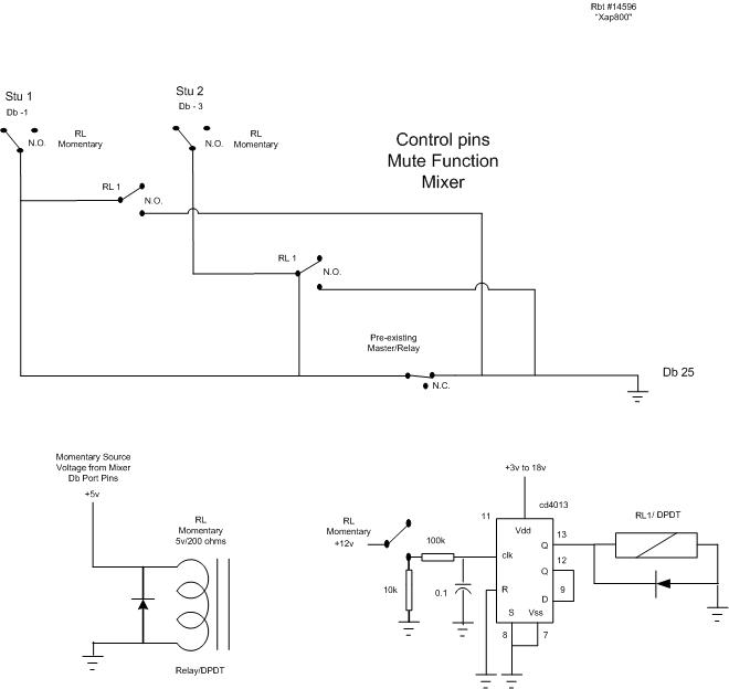

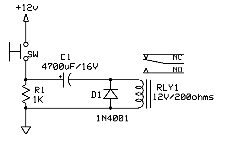

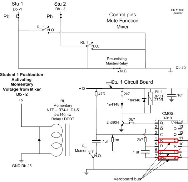

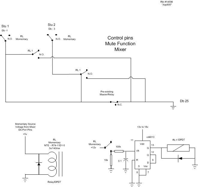

Is it possible to do this with a 5vdc supply instead of 12vdc. Of course with different values.
I'm trying to use a port pin that has about 400ma to drive the circuit. I want to switch a DPDT relay momentarily with the 1 second hold time.
This is the circuit in question from another post. (Thanks goes to KMoffet)
